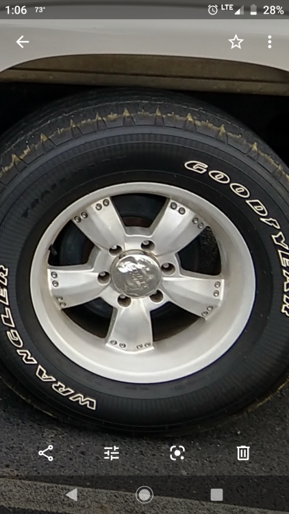

Just bought sietta crew cab 1500 a month ago, has 94000 miles on it and runs and looks great. Until it rained for 3 days straight and there was water under hood latch on driver side. Does anyone have any fixes for it? And truck came with after market rims, caps say cruisin alloy. Been trying to find more information on them to decide if I want to keep them and replace a few caps or get rid of them. Any help on either subject would be greatly appreciated!
Looks like a standard cap. When you take the rim off the cap will pop out the back side. Take some measurements and order 4 replacements. New caps wont have the name, so they should look even better.

No sunroof, but been going through forum and  think it's either in the door panel or coming through fire wall. Going to check back vent also. I've never had aluminum wheels and don't know much about how sturdy they are. The roads where I live are garbage. Years ago I had chrome 20's and a new pot hole that came up over night caught me off guard and ruined both passenger side rims. Any need to worry about those?
