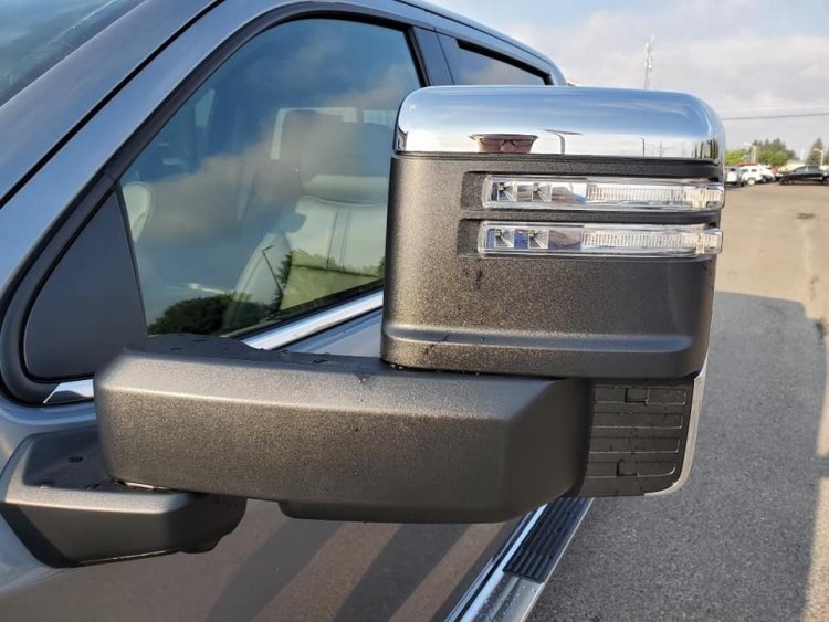

No, the new ones do have cameras available
Cameras look to be mounted in the base of the mirror rather than on the mirror like the non-towing examples. Small bubble on each side of the base.
Theoretically there would be three different towing mirrors. Base, manual fold and extend, power fold, and power fold with cameras.

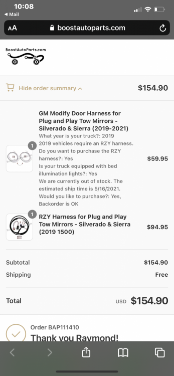

I’ve looked at the pinouts, the plugs will be the same for the power fold tow mirrors as the standard power fold / power fold with camera mirrors. There is an additional plug for power extending. So it appears if you got the 2020 tow mirrors and your truck already has power fold, you’re good. If you don’t have power fold, all the other pinouts are the same so motor/ light functions should all work as well

Most likely, from what I see on the schematics and pinouts, you’d need a set of 2020 power fold tow mirrors, not the accessory mirrors (mucho $$), the power fold window switch and possibly a new door wiring harness for driver and passenger. All depends on what current options you have. If you have power fold now, it looks like they’ll be plug and play.
