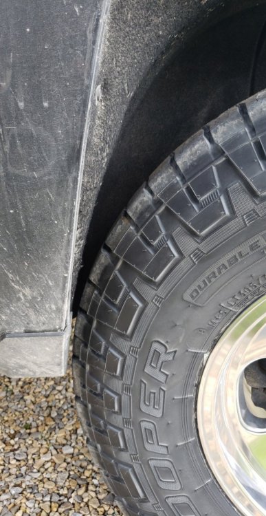

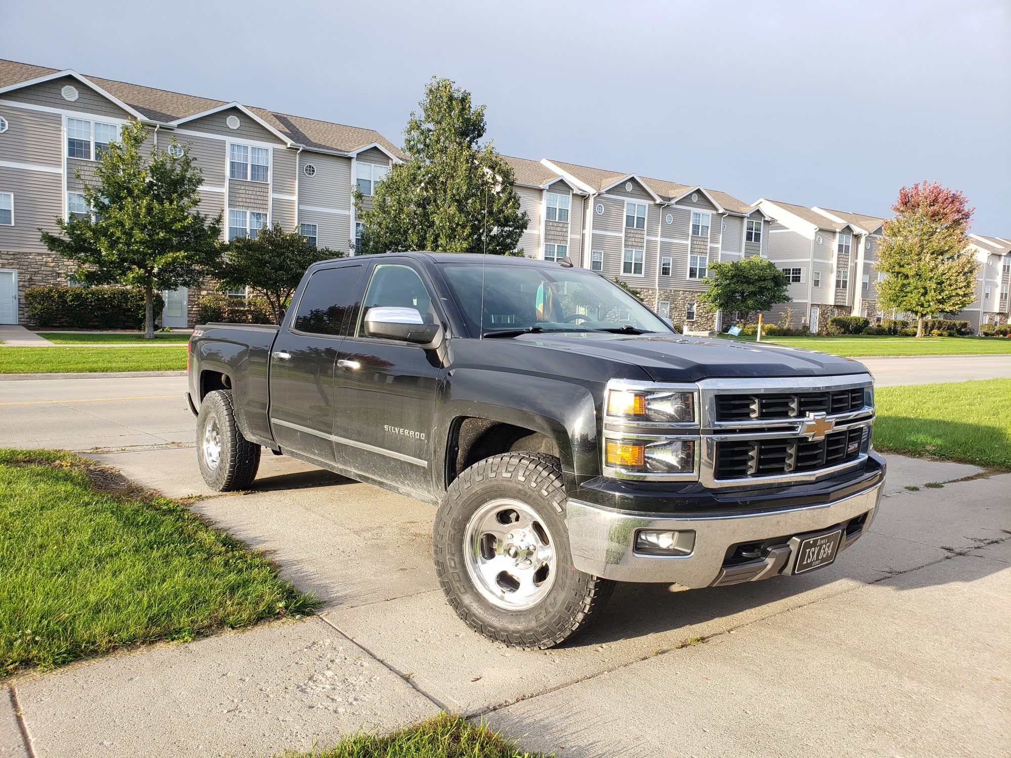

I have a 2014 Silverado 1500 2LT with a leveling kit and a set of 305/70R17 Cooper Discoverer AT3s. I had to do the norcal mod to fit them, and admittedly I need more lift to fit them well. I was wondering if anyone has run into the issue of trying to run mudflaps with the norcal mod or just oversize tires on a close to stock height truck? I travel gravel roads every day and my paint is getting beat to death!

If it doesn't rub your fender wells now, adding flaps isn't going to either. Tires are round, and the tire will increase distance away from the flap as you get closer to ground level.

If they mount on top of the rocker guard and wheel well liner they will make contact with the tires at some point

You only need a nut hair's clearance, I think they'd make it!
Personally I don't like to fill my wheel well with tire because I understand the need for suspension travel on a truck that is used as a truck, but hey! Squeeze it on in.

Needs smaller tires otherwise any of the GM or aftermarket mud flaps will just get ripped off.
