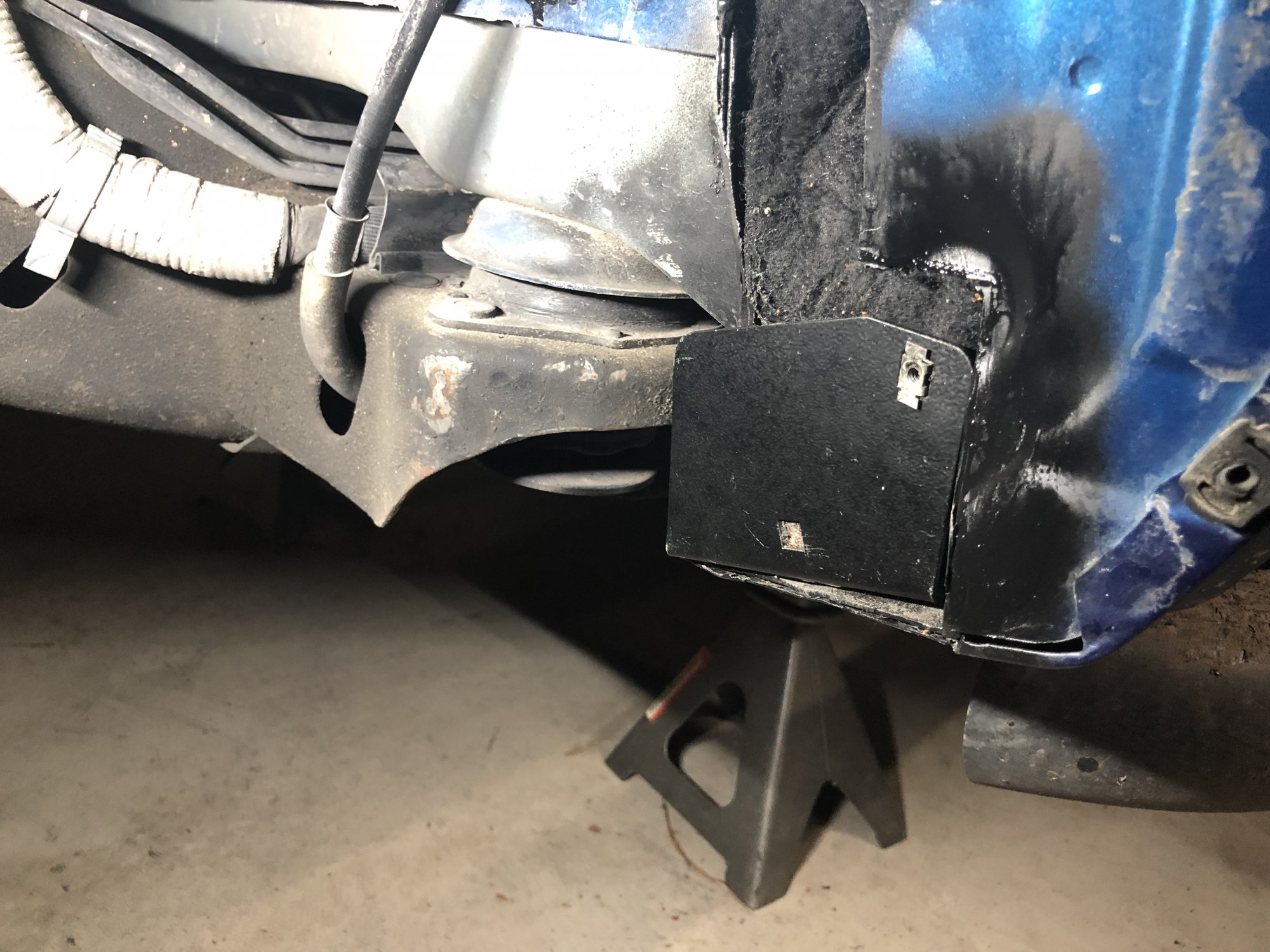

The only way you are going to get those 12 wides x 22's to fit is to NorCal it.  It's an easy mod to do, better to do that or find a shop that can do it for you than to lose all that $ on your setup.  Nice wheels by the way, i was looking at the 1.4's in the brushed carbon.
Don't be a chicken. Norcal is not that big of deal and you can run what you have. 22x12 is not an easy fit. Now you know not to trust all the YouTube guys especially custom offsets. In the real world it doesn't work that easy. Can be done for sure but not without mods. Plus who wants 33s with a 7" lift.
Yeah man that looks better, but still wont work. At least not for me and I'm rollin 20x10 -12 offset on 305/55s. All that the metal behind that plate needs to be either shaped or removed. Just like the norcal. That would work if a guy just had a pinch of liner rub but even then...

You have to trim out quite a bit for the plates to be installed.
That's what I did.  Works. And does not interfere with suspension at all in offroad scenarios. Running a 22x10 -25. 33x12.5

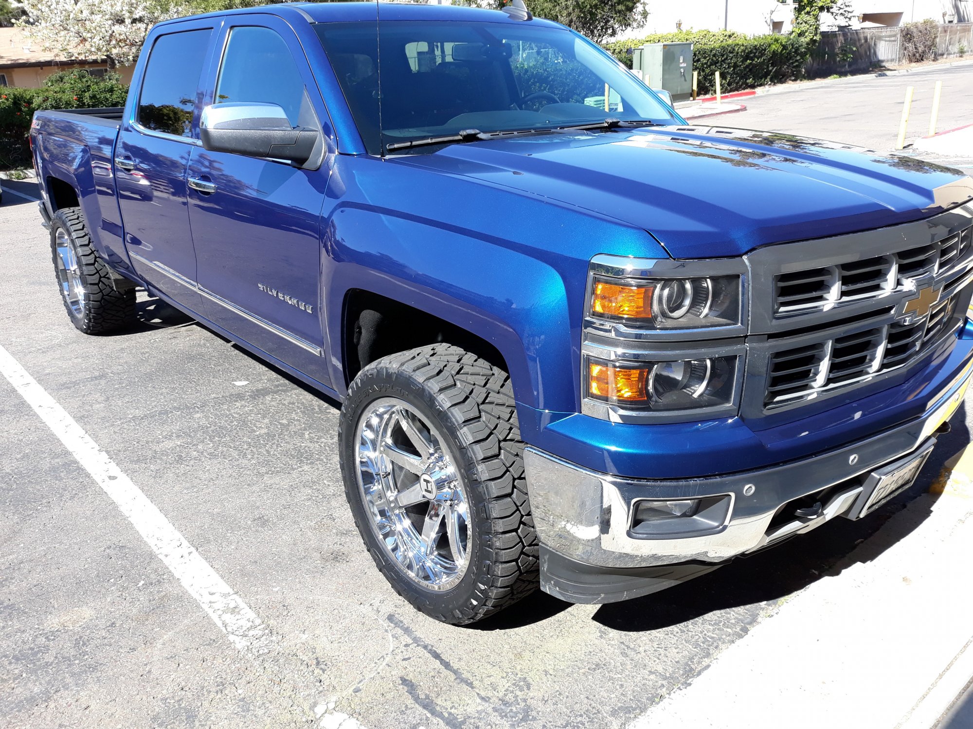

Pic of your truck?

I don't have a pic with the plate not installed, but the whole pinch weld is gone to the cab.  The plate just gives you the ability to mount the wheel liner back  nicely.  I'm also on 10 wides with 34s, no rubbing.
Your alignment can effect this too. I cut and am running the same plates without issue with more offset. Just shows your mileage may vary.  I purposely trimmed as much as possible so I'd only have to do it once. I didn't cut into the pinch liner. Just hammered it flat with a mini sledge.  Actually came out so clean you can't tell I did it unless you knew what you're looking for.
Yea i had to cut that pinch weld off aswell. Thats what i was talking about. Sounds like it will do then. Whats the cost of these brackets?

Cheap, $18
https://www.roughcountry.com/gm-1500-inner-fender-trim-10002.html?gclid=EAIaIQobChMIs_G7u-ie5QIV8ZFbCh1ftA2QEAQYASABEgIrq_D_BwE
