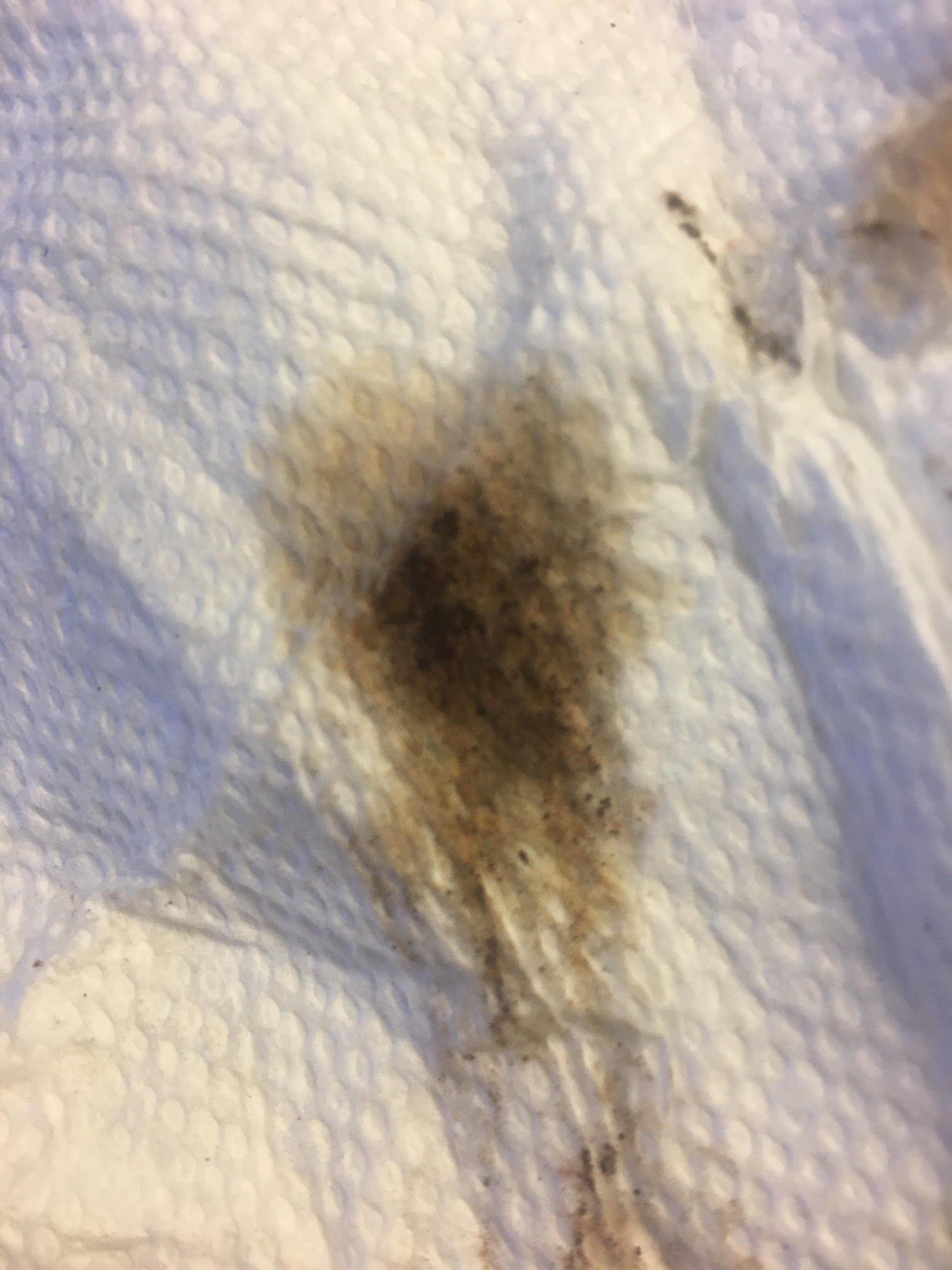

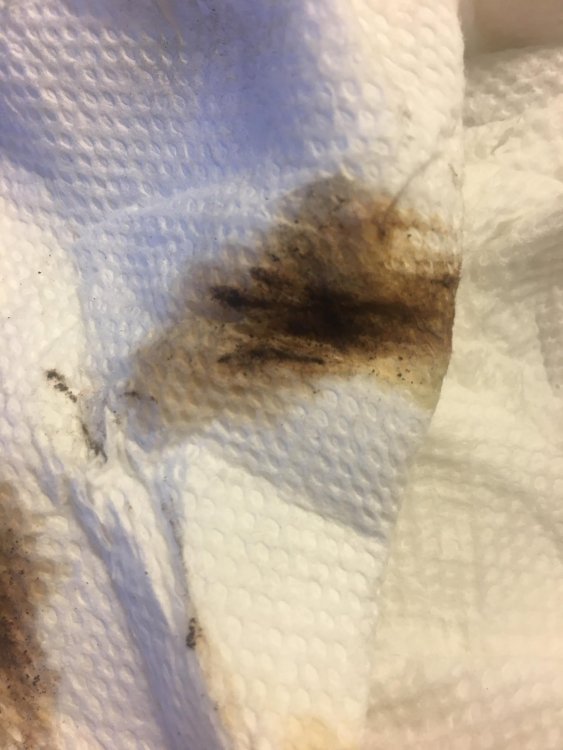

Hello all,
I decided to check my transmission fluid today on my 2017 Sierra and when I pulled out the dip stick there was a dark sandy substance towards the bottom of the stick. I cleaned the dip stick, put back in and could notice that when I was sliding it back in I could hear it scrapping something grainy. I pulled the dip stick back out and check and still saw some of the sandy substance. The fluid did have a dark color to it. Keep in mind I just had the transmission repaired\rebuilt when the truck was under 10,000 miles. Supposedly a incorrect assembly at the factory. Now I am at 21,000 miles and seeing this has me concerned. See the pics below of the paper towel.

The black bits look like torque converter junk, coffee grounds is the best description.

Just dropped it off. The same SA that told me last time the noise I was hearing was normal checked me in. I express my frustration and showed him the pictures. He has the nerve to tell me that the transmission fluid color will change over time. I said I understand but not at 11,000 miles after the last fluid change. The fluid smells and it had the debris in it. I showed him the pictures and he was like well yeah it should not be that dark. Duh!!

Sorry for not updating sooner. Finally got the truck back on Tuesday after the dealership having it for almost a week and a half. So they had two master techs look at it during that time. One said the grit on the dipstick is rust from the dispstick tube itself and he then went to the lot and showed the same issue in other trucks to the second tech. The second tech said no, there's an issue as the fluid should not be that dark. Well finally they dropped the pan and found no shavings, transmission looks good, fluid was a bit dark. They decided to flush the fluid and then the second tech tested the transmission fluid thermal bypass valve and saw that it was failing. I had been commenting to the SA since I bought the truck that the transmission temp was getting up to 230F sometimes and he kept asking, are you getting an alert? I said no, then he said that's fine there is no issue. I would always tell him anything above 200F is going to cause fluid and transmission issues.
