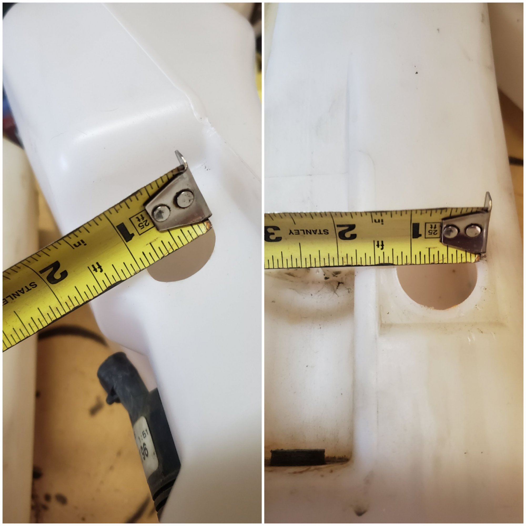

I need to replace my washer bottle and something so easy had turned in to a pain. They first gave me Dorman 603-025. That's way off. Then a Dorman 603-018. Ok, that looks like it. But no, the hole for the low sensor is smaller. I'm still searching but anyone know the real Dorman or equiv pn? I have a 99 Silverado 2wd 4.8. or do I have to get a new sensor (if the plug fits). Heck, I'll even take one without the sensor. Seems the light don't come on with it unplugged anyway.
Looks like the gm pn is 15035069 l.
Tis
Using your number looks like Dorman 603-106 Look at that one. Amazon has it
Or 603-072 doesn't have sensor
