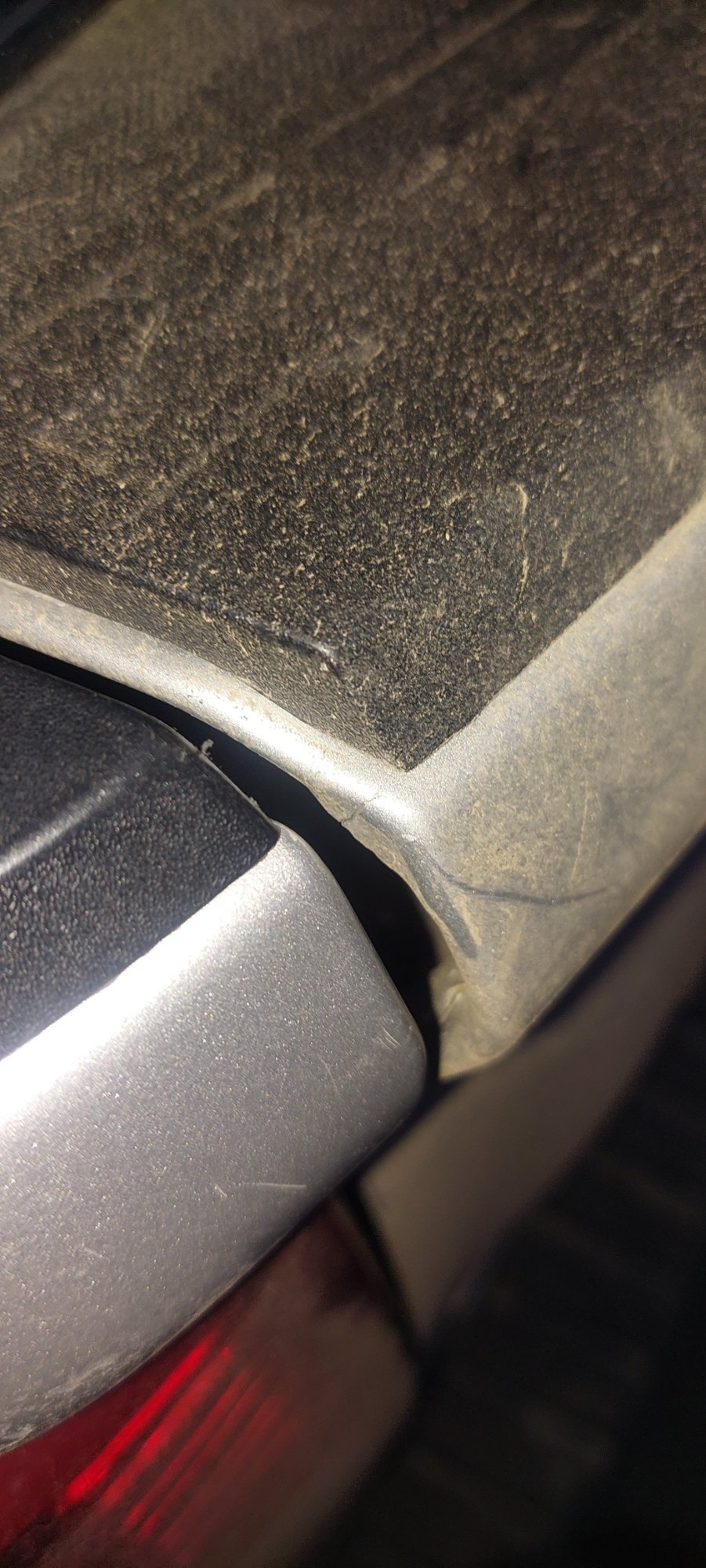

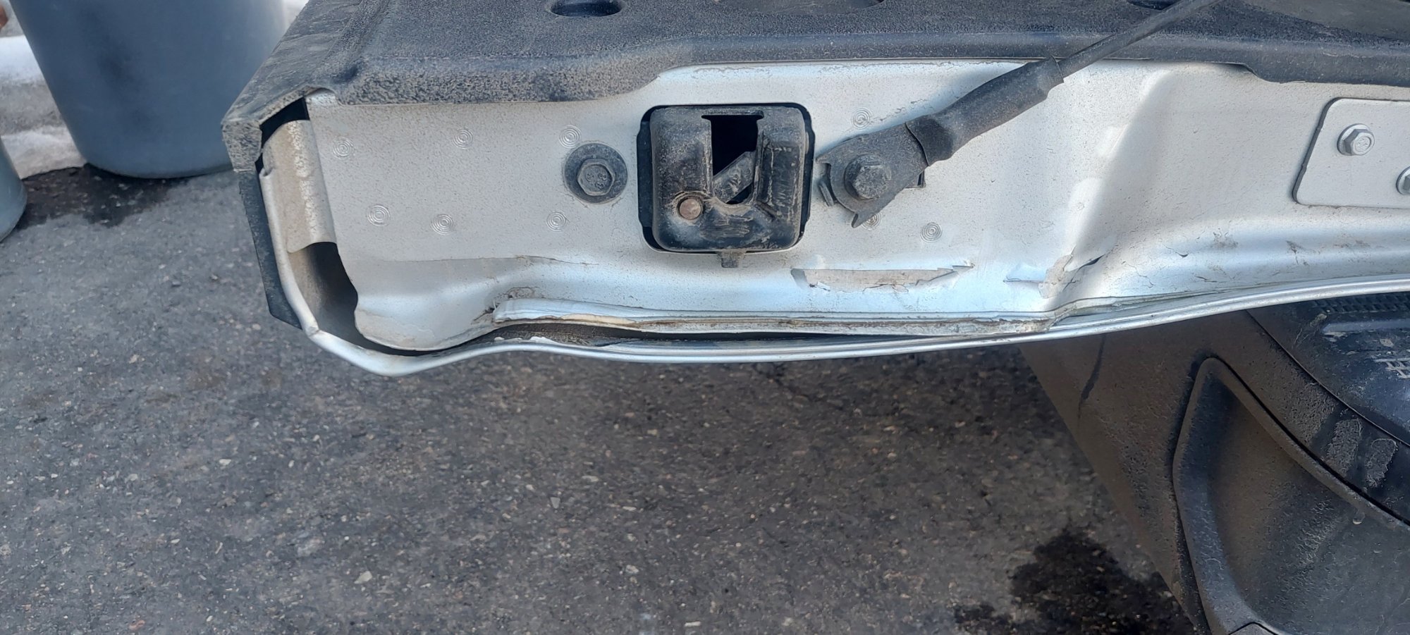

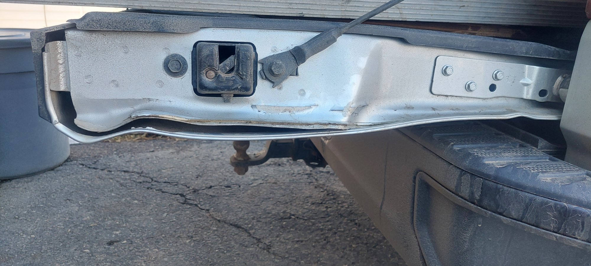

Well I just had a big issue with mine.  I have a 21 Silverado.  Had noticed since new that any time I loaded anything into the truck with the gate down, my camera assembly would pop out.  Well big issue arose this past weekend while hauling my snowmobile.  The side of the gate broke a weld due to the machine sitting on it.

Bummer... I expect we will see this more often. The tailgate is a prime candidate for weight savings engineering. I've never witnessed a failed tailgate on a square body or GMT400. GMT 800s the cables would break.
Seems like early on they were 'over engineered' because some loads would inherently be placed right on the end during loading or unloading. As trucks became used less for load carrying that safety margin becomes less relevant. As a percentage of users those loading the tailgates like this are negligible.
I'd bet a tailgate from a 92 model truck could hold more than from 2022 - I'd bet 500 lbs more... any takers?
Another big issue is that the tailgate is not removed easily due to power latch and camera, etc.
When loading heavy pallets on older trucks, the tailgate was easily removed so a forklift could set the load onto the bed, NOT the tailgate.  ...The forklift could then push the pallet further onto the bed.  ....Heavy loads placed on the tailgate only strained the support cables, not the tailgate itself.
I bought my truck as a WORK truck.  ....Many of the "features" make my work more difficult.
While the trend is to raising the height of these trucks, the tailgate height of my '21 W/T is 4" higher than my '88 or '98.  ....That makes a huge difference when lifting heavy objects.   ....Bed sides are also higher which makes reaching over the sides almost impossible (I'm 6'-1").  ....Certainly not conducive for a WORK truck!
