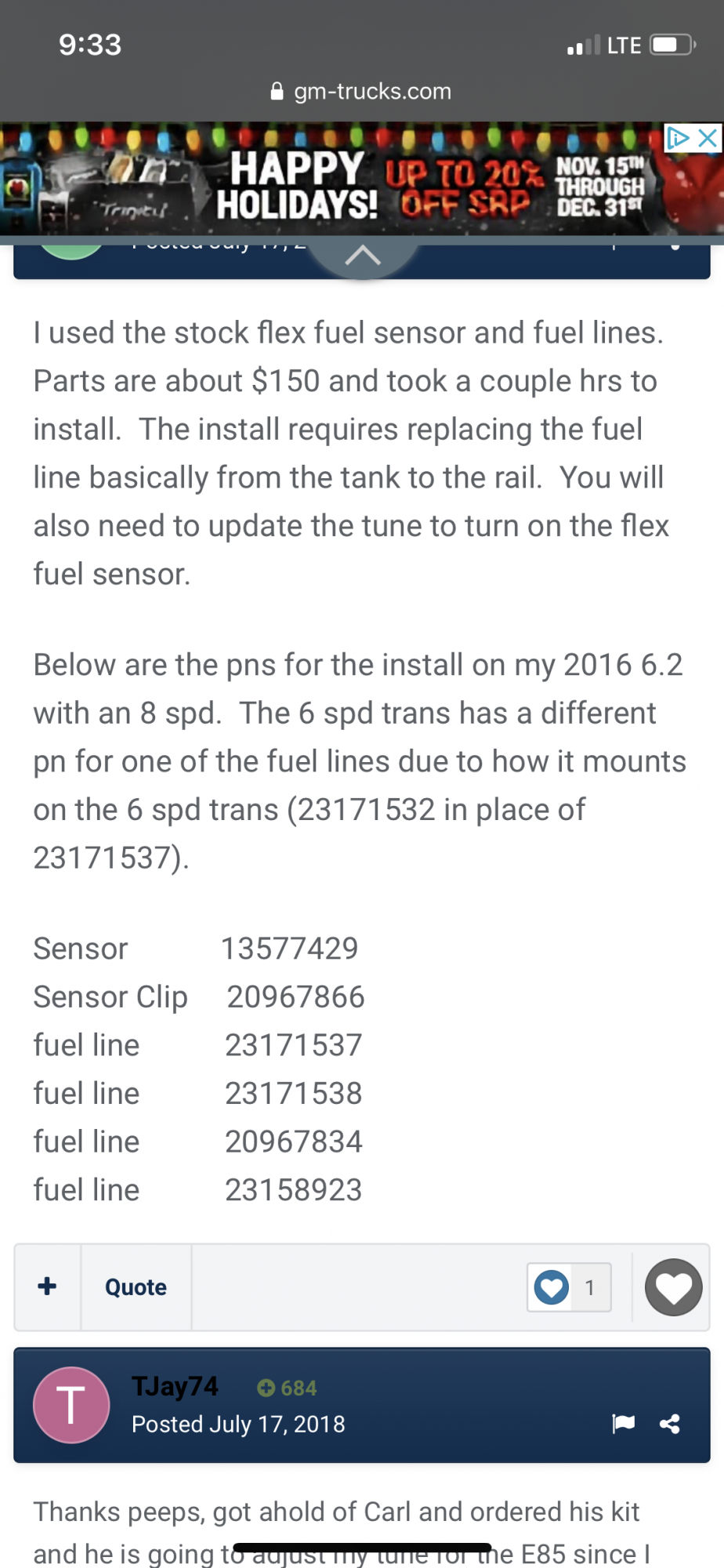

Thinking about adding the E85 sensor to my 6.2 and I’m wondering if anyone has a list of all the part numbers needed for adding it. I know I can order the kit from a few places but wondering if it would be cheaper to just order part by part? Also does anyone have a write up on the install?
The search feature is your friend.  There are several write ups including one that concluded earlier this year.  I think the truck was white, don't remember exactly.  All the parts were listed too in the thread.
Here is what I watched to add the E85 sensor to my truck for about 60$.
If you have HP tuner he has a video on how to enable it in the tune.

I may do it this way. It’s going to get tuned in about 2 hours so I’ll talk to my tuner about it then
My sensor was in a slight different spot since his was a regular cab and mine is a crew cab.  So I put mine over the front of the gas tank and just extended the plug.  But it's the same idea.

You don't need all those parts with the way I posted but it's you truck.
True. I’m just worried about leaks. My tuner is as well

This will only work if getting a tune?
Mine has a dummy plug from the factory, maybe yours fell out.
Yes, a tune must be done to activate the flex fuel features.
