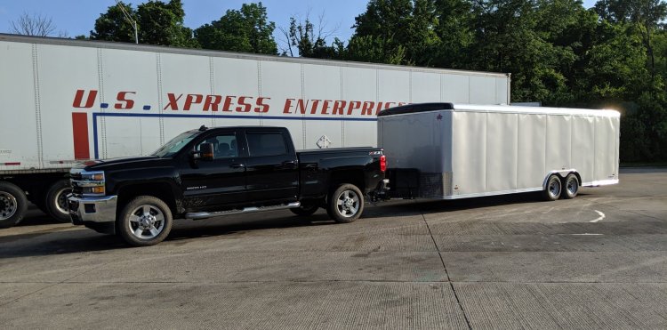

I checked back through my photos and found I got 8.4mpg towing this 335miles through Kentucky and Tennesse (not exactly the Rocky mountains but by no means flat land, either).  I didn't get an exact weight but I believe it was around 7000-7500lbs loaded, maybe a bit more.
I'm sure the 6.2 would seem like a hot rod motor compared to the 6.0 in my truck but there's a lot more to towing than a powerful engine.
