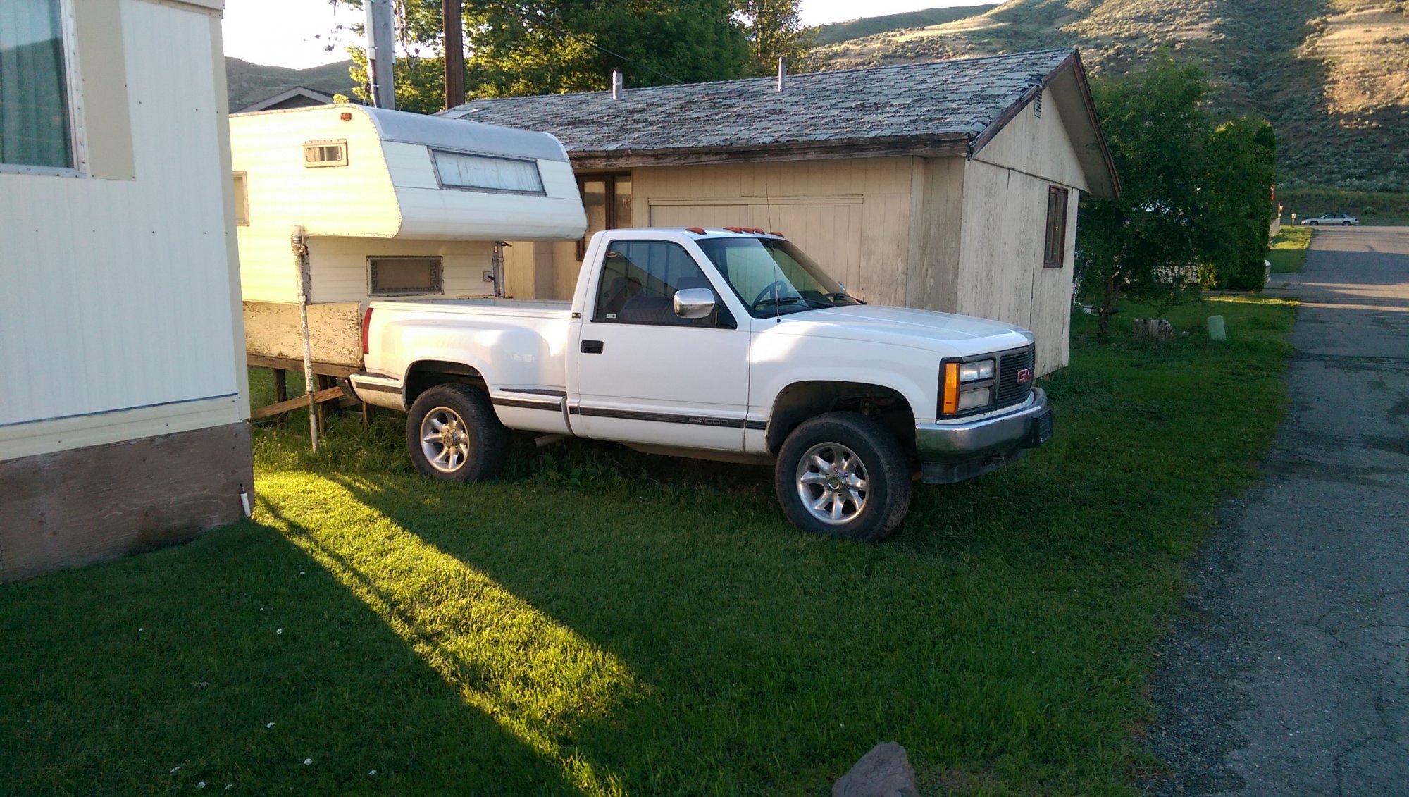

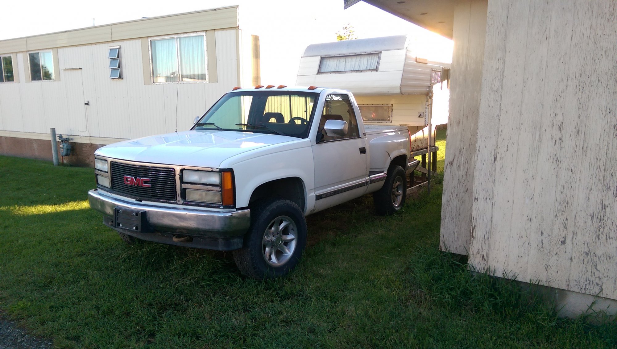

I was thinking of running TBI on the older engine. the truck its going into is a 92 GM 4x4 short box. I was going to try and use as much of the modern stuff as i could
the diesel transmission is what im going to put behind the 454. as a combination. i want the extra duty transmission to take the power of the engine.
