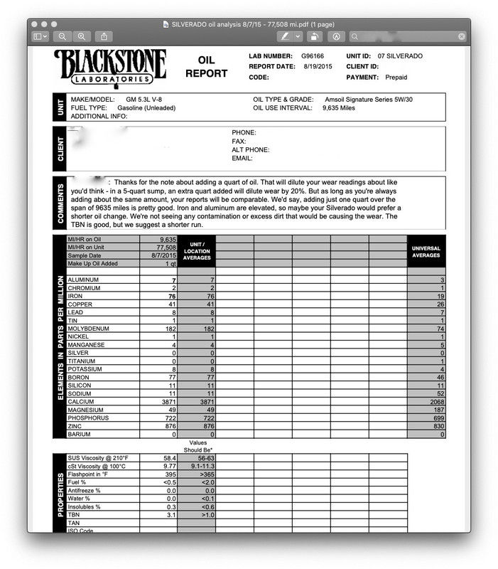

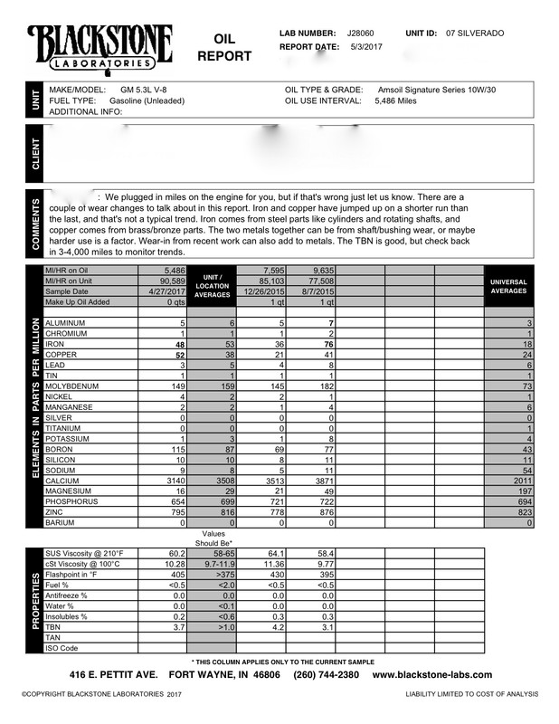

I've been running 10w-30 in mine for the past 30k miles, when my oil analysis was showing signs of the notorious #2 cam bearing failure, plus high levels of piston ring and piston material in a prior analysis. I'm going to run this one until the block ventilates itself, or the camshaft snaps in 2.
Just turned 100k miles last week. Won't be long now ...
Have you posted this analysis before? If not, you might post it

It doesn't tell you a specific bearing. High levels of brass and iron, combined with the engine's known failure points pretty much tell you what is happening. It's usually the #2 cam bearing that walks out of its bore, but others have been known to as well. 9 times out of 10, it will be #2, historically.
I have a few times, but they're either buried in 200 pages, or got yanked when Photobucket tried its extortion scheme.
Here's the 2 I found - there's one missing (the one at 85,103 miles - on that one, they noted that they were amazed at the decrease in wear metals just by changing to 10w-30. There was ALOT of highway miles in that period, though - 2 trips to FL and back hauling cars).  Amsoil Signature Series for both different weights:
