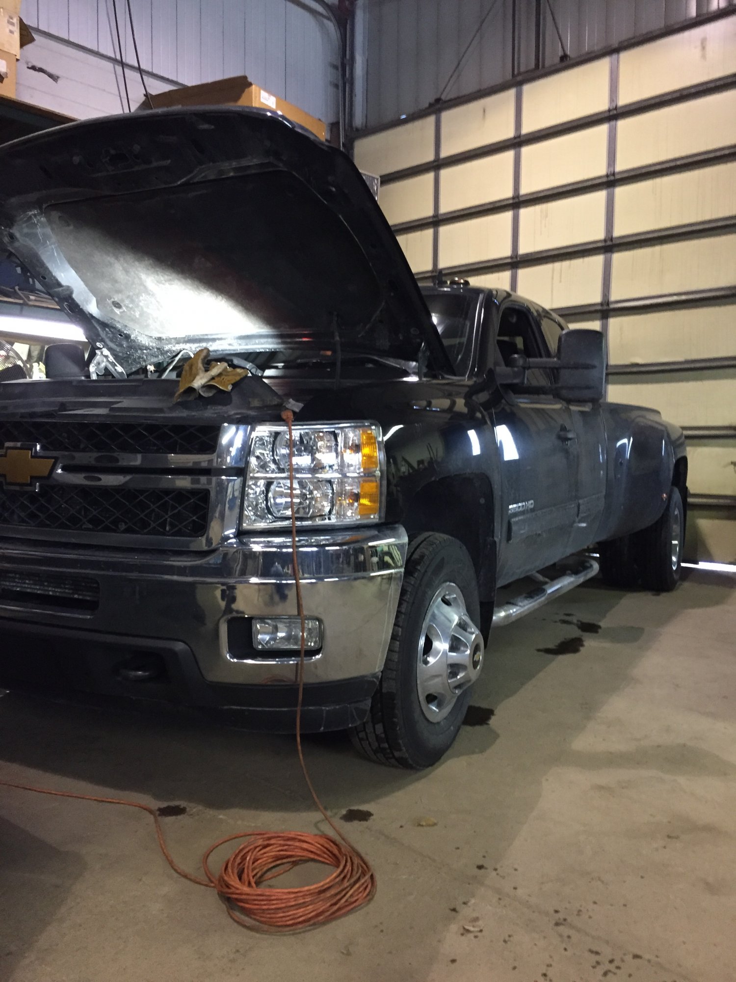

Okay I have a random misfire code 300 302 304 307 replaced already o2 bank 1 upstream and down stream,new plugs,new wires,new coils, new injectors,maf and map, truck will idle fine then it won’t,check engine light will blink and then stay on,if it’s idling ruff and I take off it stumbles till I hit 25 or 30 mph and then I punch it and it runs fine for an hour down the freeway, then when I stop it may idle ruff or fine what is going on with this truck and it has a lot of power,help......gas engine no flex fuel
