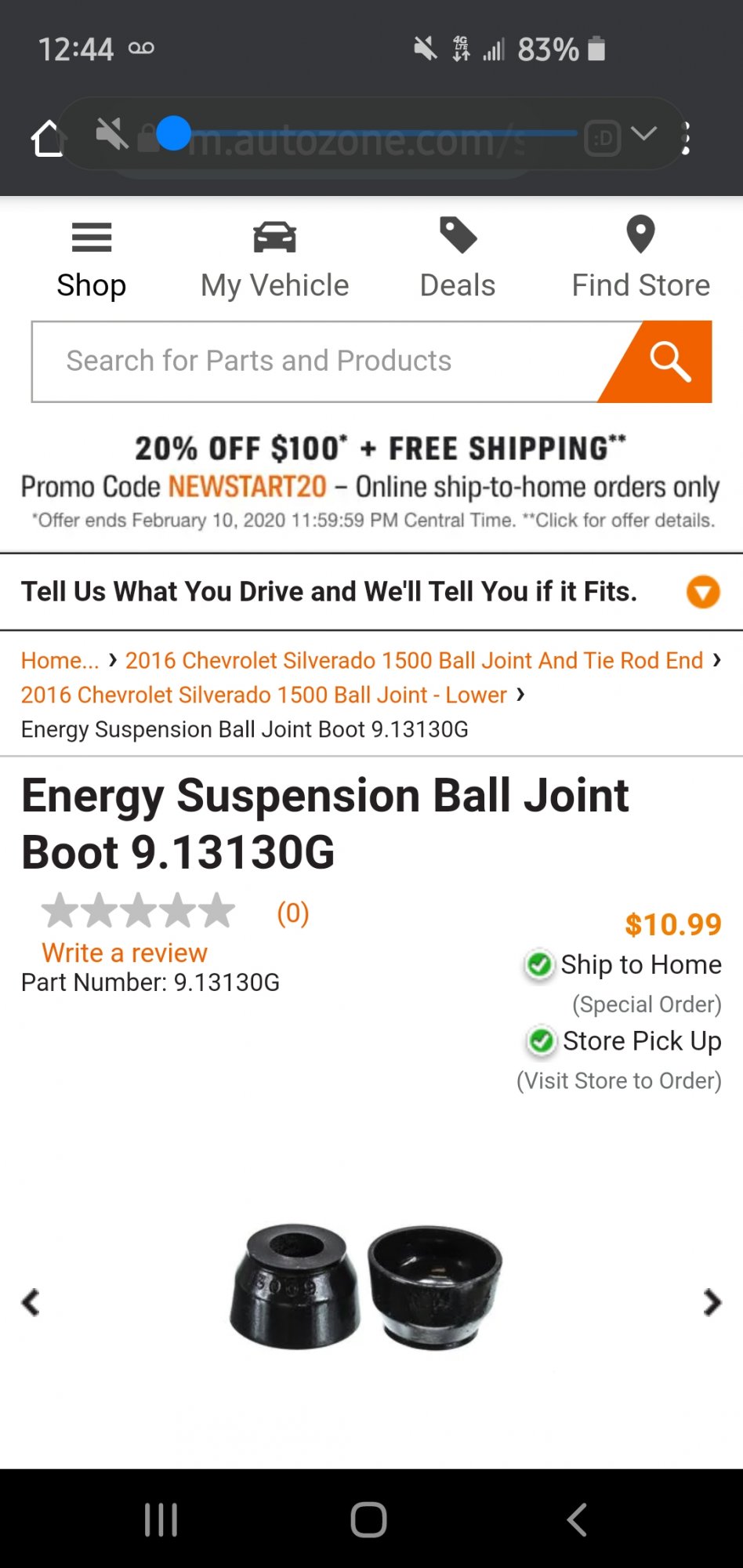

My truck just turned 70k and last time I rotated the tires I noticed the bushings on the tie rods looked about depleted. Factory sealed of course so I tried injecting with a grease needle (read on a forum) to try it out but they ruptured a tiny bit and have since started to creak/ vibrate on the road. Any advice on a company/ part? I don't feel like I need to replace the whole rod or ball joint, just the bushing in between them.
I've seen items like these but they're not easy to find on the web

That's not a bushing it's a boot to keep grease in and dirt and water out. If they're making noise that means the ball and socket is lacking grease. Probably best to replace the whole tie rod. I would recommend factory as gm has generally made really good tie rod ends that far outlast most aftermarket parts.
