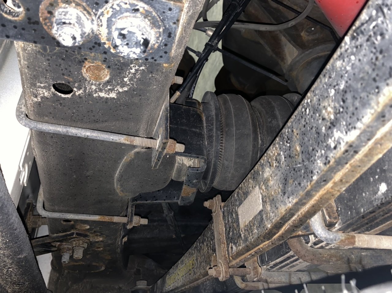

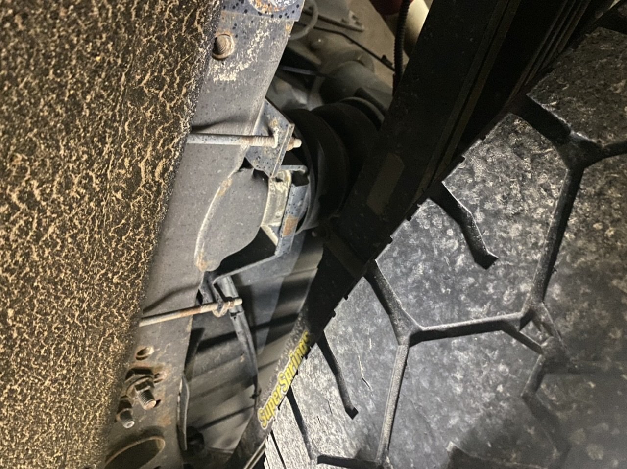

My truck sits higher than many when I park by them.  It has 275/65r20 Nitto EXO Grappler AWT Tires.  It doesn’t rub at all or even come close.  It does have the Air Lift Air Bags installed along with Super Spring add leafs.  I love the way it sets and looks but it rides rough as hell in the back.  I have done research and a lot of said this is common.  But it is extremely rough and I wouldn’t think it would be as bad as it is unless I have my race trailer hooked up.  I looked and it seems my keys are at full lock also.

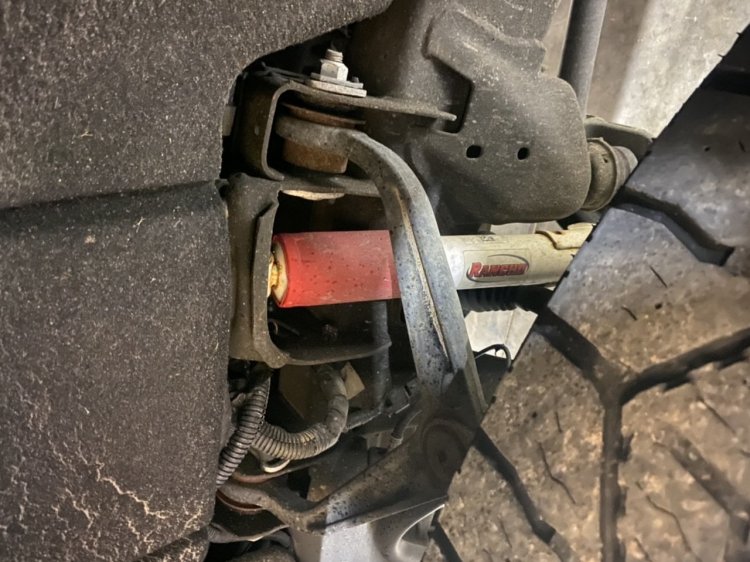

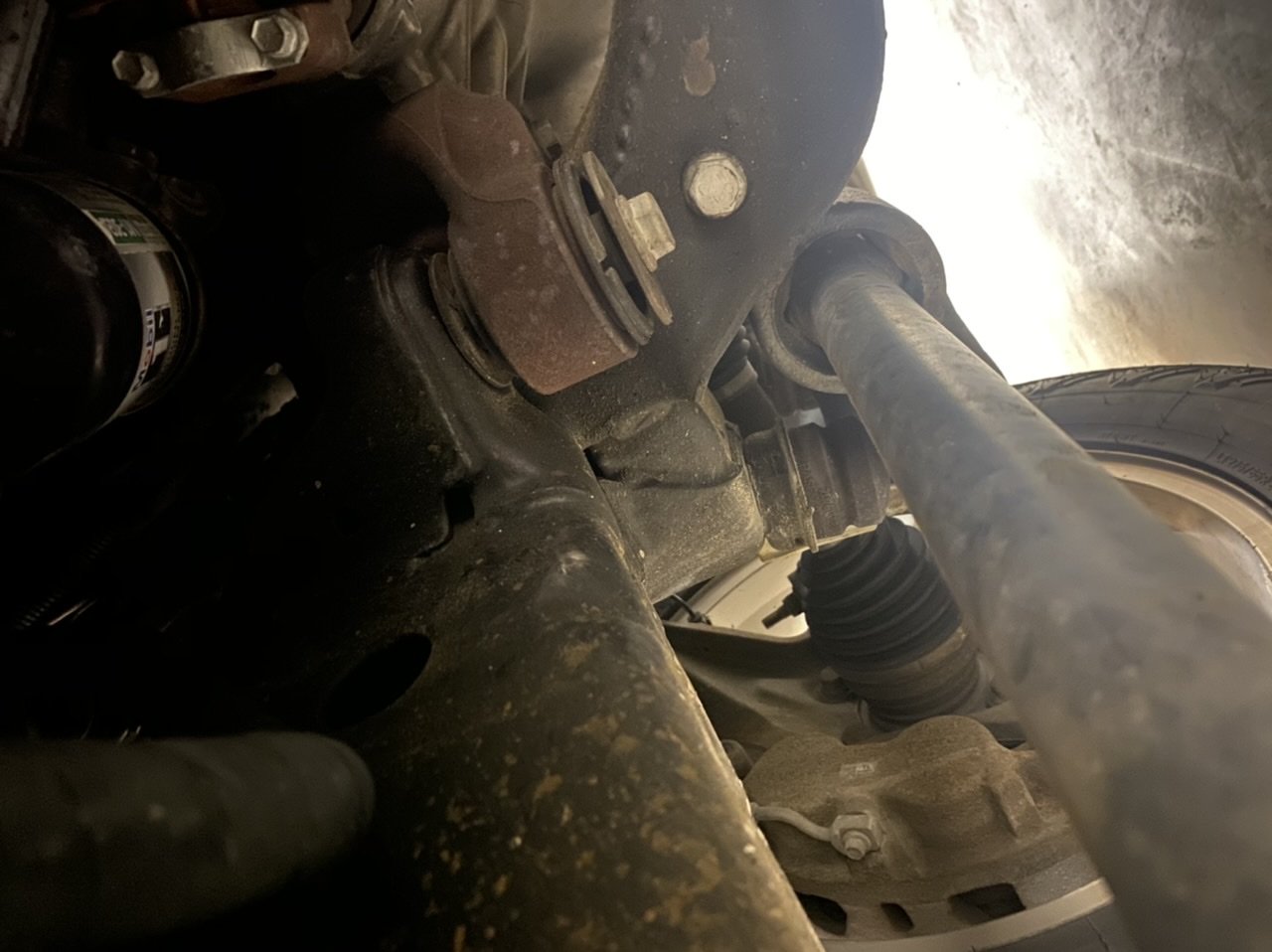

-Does this truck have a body lift on it?  Stupid question but I don’t know what I’m looking for.
-Is there anyway to improve the ride?

There's basics like:
-turn down the front keys to get it back to the original height.  If you want it leveled, get a proper lift so the suspension geometry remains the way it originally is.
-if there's more than 75k miles on it, you might consider new shocks all around
-do you need the supersprings for hauling your trailer?  you might consider removing them if not.
-do you air down the airbags when not hauling
-lowering tire pressures helps a bit (so they aren't at the max pressure), course, remember to air up for hauling...
