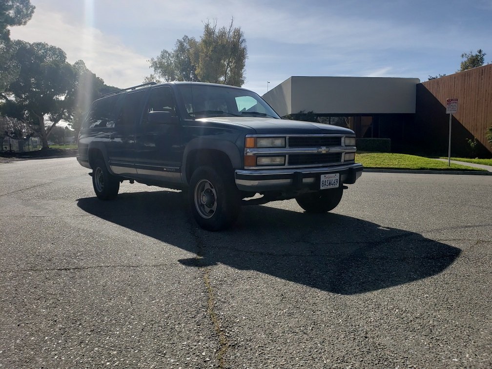

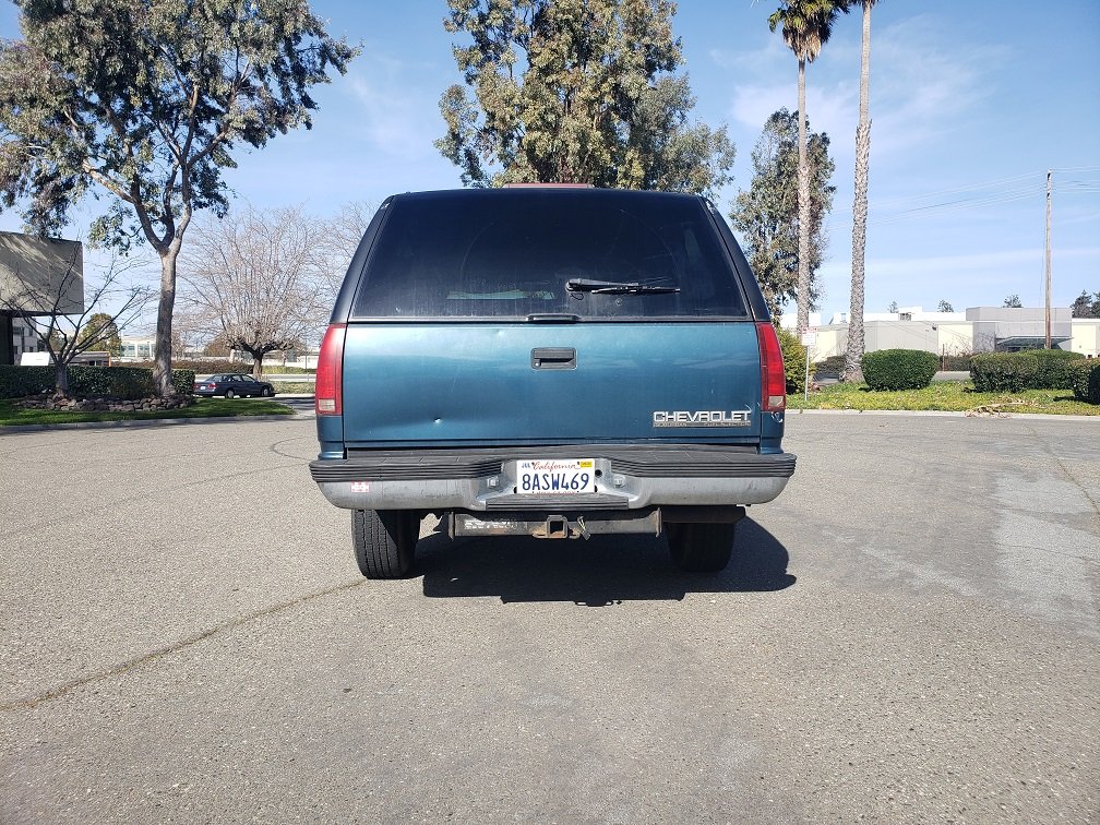

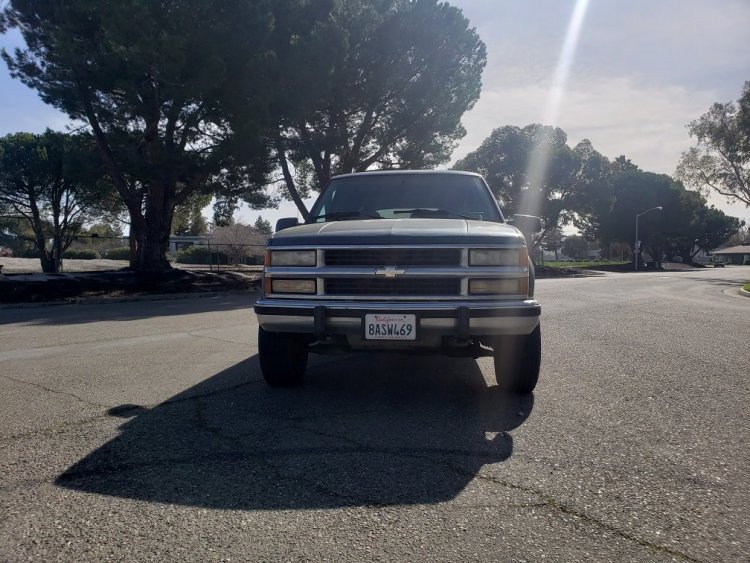

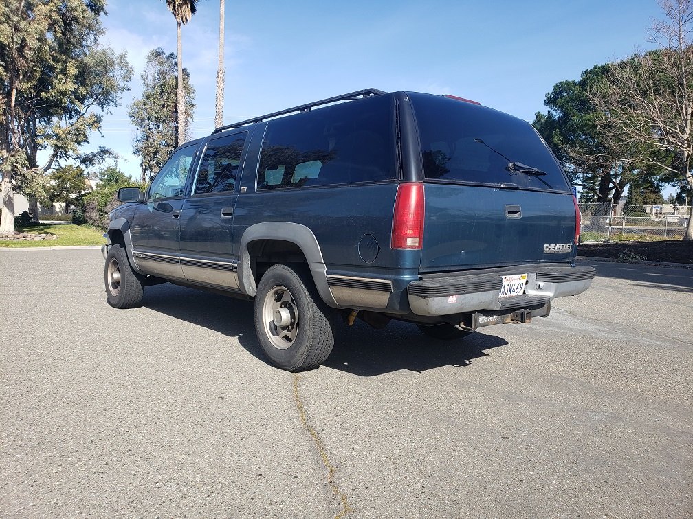

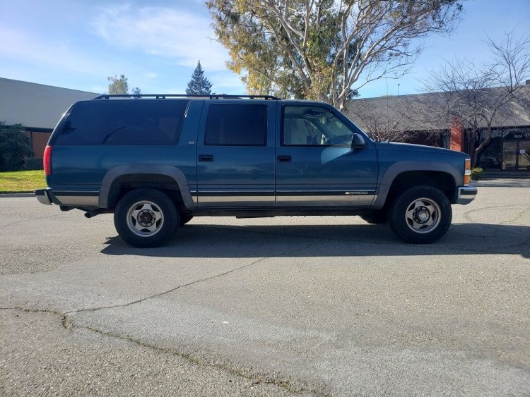

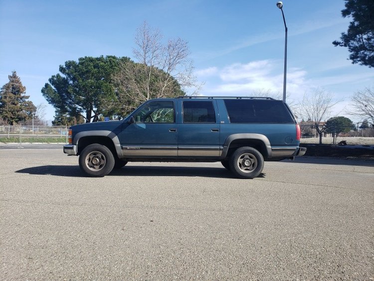

Allow me to introduce myself, my name is Wile E Coyote, GENIUS         Tom
Alright, so here is Santa Clara, California.

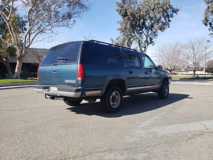

This is my 94' Chevy Suburban K2500 Silverado.  454 engine.
Just purchased from a gentleman in Los Altos Hills , only $1,750!  Runs good, SMOG passed!
All 3 sets of keys, owner manual, and even a self-introduce cassette tape!
The first time I saw its cassette deck, I thought it was 8-track,
He wrote in the ad on Craigslist, he sold it because don't drive it often.

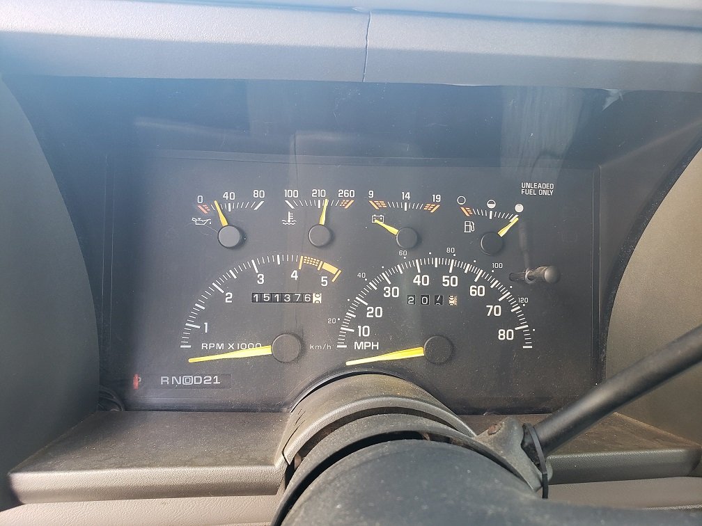

I found a maintenance label on wind screen, its next maintenance supposed to be on 05/22/2014 at mileage 153,000. but now is early 2020, 151,000, so most time it was just sit there.
So maybe I should change engine and transmission oil
Now it have some little problems, I think I can fix some of them, maybe just a visit of Pick-n-Pull (junk yard).
1 Check engine light is on, code is 35, its idle speed is about 1,200 rpm, even it have heated up. // Fixed, mouse bited vacuum tube for idle control, just replace, now it is around 800 rpm;
2 ABS light on, forgot the codes, many codes.  // Fixed, get an ABS model in Pick-n-Pull;
3 Brake feels slip, I heard a mechanical said brake pad or shoe also have its time, if a car sit there for years, it will harden, caused brake slip, so still need to be replaced;
4 AWD not work, transfer case is operateable, but 4x4 light don't light.  //Fixed, AWD actuator shorted, get one in Pick-n-Pull;
5 Dash board back light don't light when head light is on.  // Fixed, fuse problem.
6 Low beam will off when high beam is on, and I plan to swamp into the 4-small-glass-lights design on  89'-92', I have got parts from Pick-n-Pull, just wiring job it will done;
7 Rear speaker sounds terrible, and one was blown, suspect to be faulty amplifier;
8 The inner door handle of drive door is broken.  // Fixed, Pick-n-Pull.
Oh, any one have its MPG data for 454 engine?  I can't find it on internet, they all about 350 engine.
I plan to have a Bay Area round trip , the route is:
Santa Clara -[US101S]-> Gilroy -[ US101N, I280N, CA1N ]-> San Francisco -[ US101N ]-> San Rafael -[ I580S, I80W ]->Oakland -[ I880S ]-> San Jose -[ US101N ]->Santa Clara,
about 200 miles , if it runs well, I gonna drive it to Yosemite Valley.

Nice truck!
Yeah, it's not easy to tell it with a crew cab truck with a camper shell.
And may of my workmates thought I purchased a truck when first see it.  ?

Welcome to the site and super cool old GMT-400 Suburban you have there.
There is a guy on YouTube - 1ROAD - that has an old 4wd Suburban like yours.
Check out his site.  He lives in California, too.
https://www.youtube.com/channel/UC3HXlUp_KQwxMlhAx6MInTg/featured
Thanks, seems like this guy have done some interesting things, maybe some of them gonna be handy for me.   Subscribed
