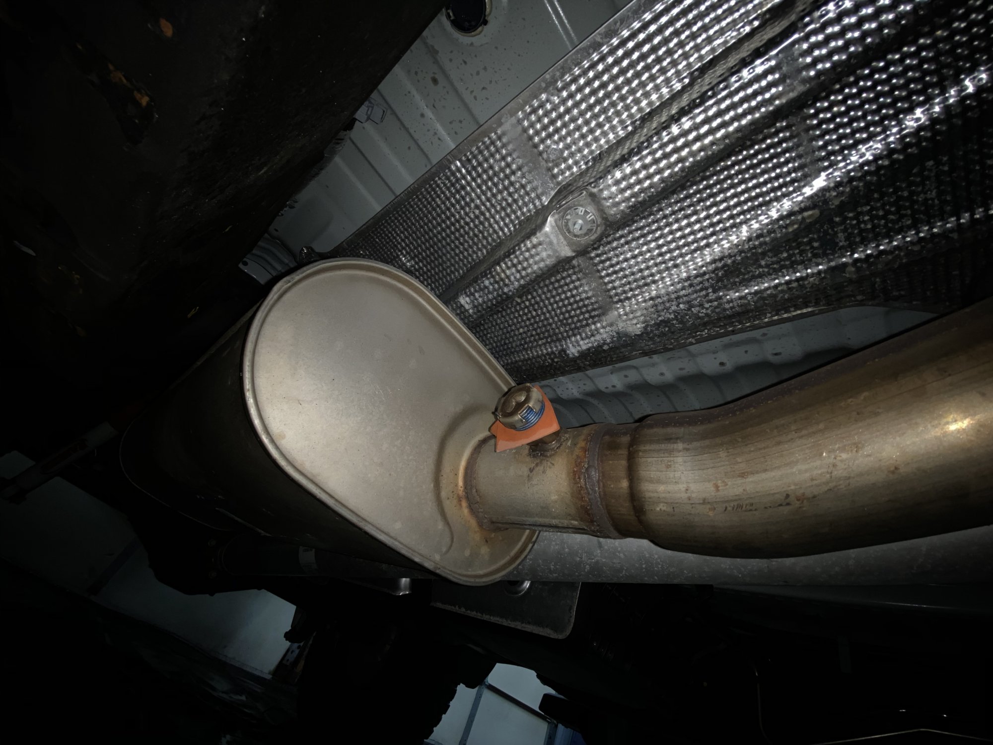

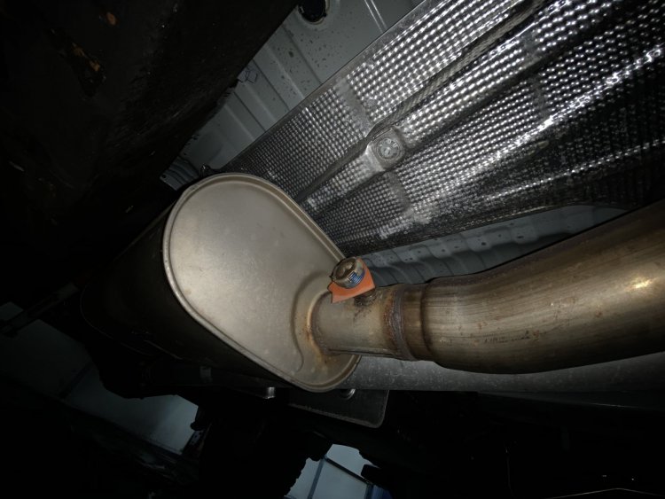

I know this isn't exactly what you want, but here is the GM performance exhaust right before I installed it.
Notice, no flappers before or after muffler, and no resonators.

Also straight in and straight out muffler. Mine enters on the side of muffler exits out the middle. Is that for a 6.2? beautiful garage floor btw.
