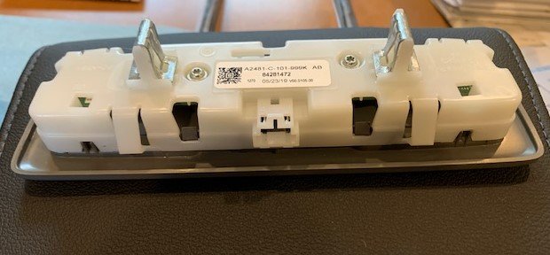

Had my Dome Light out recently.  It's two metal clips into the roof, and four plastic clips to retain the headliner.  Here is a pic from the back...
