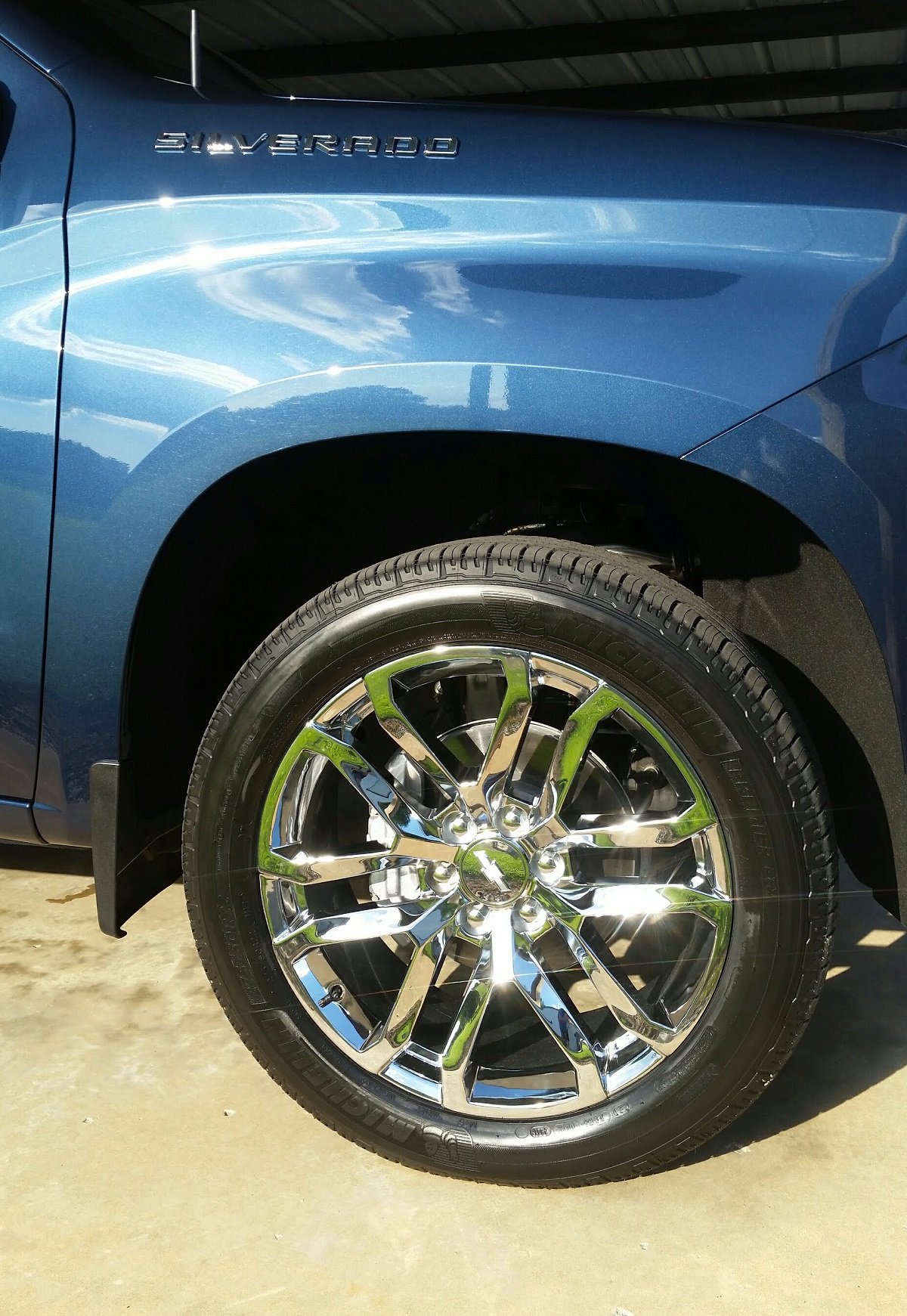

I only lowered the rear 2" using drop shackles.  Now the truck is level.  I had to spin the factory pinion shim.  There's some threads on here with lowered front/rear trucks and just some with just rear shackles.  Some others may chime in.
Which wheel is that? 20"? 22"? Looks good!
Thanks!  They're OE Creations 2019 GM style PR196 22" distributed through Wheel Pros.  These wheels have a flawless chrome finish (not PVD spray chrome) and required very little weight to balance.  OE Creations are as nice of a wheel you will find with a perfect fit that clears the new 4 piston calipers.
