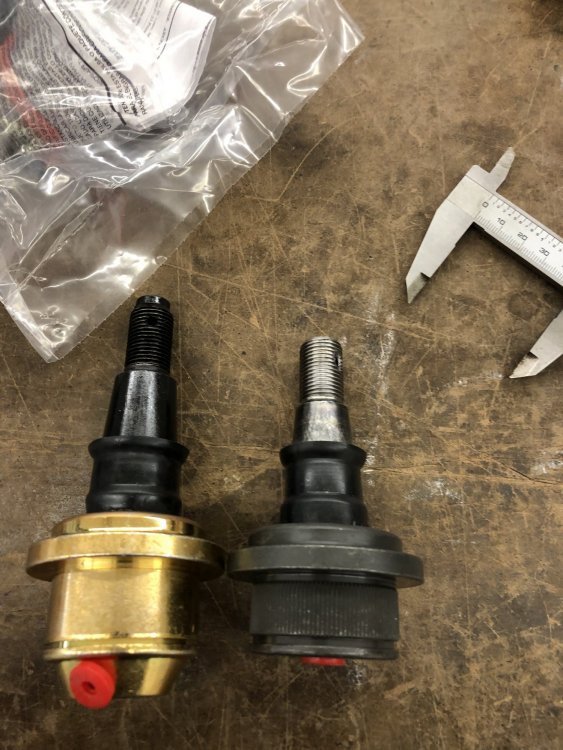

Hi all, looking for a little help.  I searched around and couldnt find my answer.  Just  bought a 2014 GMC SIERRA Z71.  The used car lot replaced the lower control arms and ball joints.  The truck came from the factory with Aluminum uppper and lower control arms, however they installed a steel lower arm but used the correct ball joint.  So to be clear, it has steel lower control arms but the ball joint is for the aluminum knuckle/arms.  It drives down the road straight and I dont notice anything wrong over bumps.  My question is:  Is this acceptable/Okay to do??  I think I know the answer.....thanks for the help!

Haha...I'm going to rock it for a while and see what happens.  I'll have the alignment double checked and keep an eye on tire wear.  There are two different lower ball joints listed for that vehicle depending on the arms/steering knuckle (steel/aluminum).  They both mic out the same where it goes into the arm; one is splined the other is not.  The brass colored ball joint is for aluminum arm/knuckle and that is what is installed on the truck.  I think swathdiver is correct, it will probably last me a year or so and I will be changing everything out.  Was just curious if anyone has run into it before.1767751380_IMG_24461.thumb.JPG.28f414fd498c0a81ffec085f7e0fdfeb.JPG
Those aren't interchagable.
Did some more crawling around...the a-arms are actually hitting the knuckle on a full turn so this cant be done (no surprise).  Have to get some new aluminum arms as I expected.
I knew it when I bought it...I know I know....I negotiated it into the price.  Its easier for me to pay the $215 to fix it myself than to drive back to him and get into a argument about it.  I was just hoping I could wait a bit before I had to do it but now that I see the damage it is doing I'll just fix it the right way.  I guess in the end this was a waste of everyones time on this board because I knew it could'nt have been right.  I suppose that it did answer the question on whether or not you can use the steel arm in replace of the aluminum though.  Anyways, thanks for those who responded.
