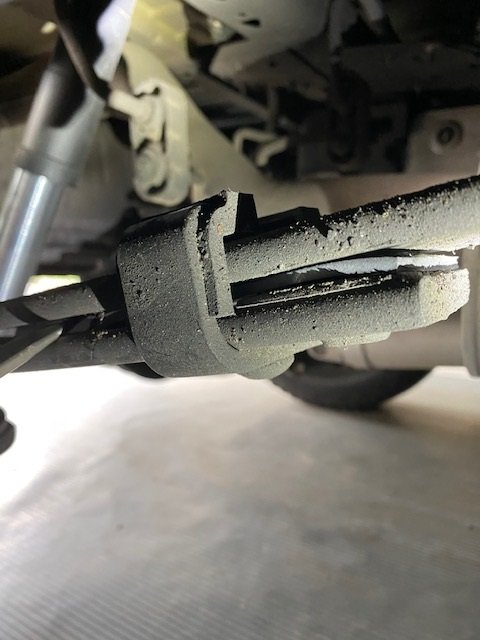

im4snow2000 Posted April 30, 2021 Posted April 30, 2021 7 hours ago, Dogdad said: Sorry for a dumb question, but do you have to undo bolts to slip in this rubber piece? I just had the leaf springs replaced on my new 21 Sierra with 300 miles on it and still have the clunking noise. Looking today I see the inserts are indeed plastic on the new springs . No. I simply jacked up the truck under the frame, to relieve all weight off the rear wheel. Once up, with the tire slightly off the ground, you can easily drive a screwdriver between the leaf springs near the leaf spring insert (on both ends of the leaf springs), and pry the springs apart, and slide the rubber in on top of the plastic leaf spring insert that is "secured" to the lower leaf spring. The rubber I bought on Amazon and was inexpensive. So far, so good for me....but it's only been a week.
im4snow2000 Posted April 30, 2021 Posted April 30, 2021 (edited) 8 minutes ago, im4snow2000 said: No. I simply jacked up the truck under the frame, to relieve all weight off the rear wheel. Once up, with the tire slightly off the ground, you can easily drive a screwdriver between the leaf springs near the leaf spring insert (on both ends of the leaf springs), and pry the springs apart, and slide the rubber in on top of the plastic leaf spring insert that is "secured" to the lower leaf spring. The rubber I bought on Amazon and was inexpensive. So far, so good for me....but it's only been a week. Here's pic of the rubber installed. Please excuse the dirt. Of note, if you have someone shake the truck side to side with moderate effort, you can recreate the noise. With someone shaking the truck side to side, you can visually see the upper and lower leaf springs moving laterally against each other.....and the upper leaf spring rubbing against the lower leaf spring INSERT is where the noise seems to come from. Whatever material they use to make the leaf spring insert isn't compatible with the steel and/or paint on the upper leaf spring....in my opinion. Nothing like buying a $50k truck and "fixing" it with $3 of rubber. Edited April 30, 2021 by im4snow2000
Dogdad Posted May 5, 2021 Posted May 5, 2021 Installed the “SPRING THING “ KIT. Works great. No more clunking sound. Spring-thing.com. Here’s a pic of them installed on my 21 Sierra . Spring-things.com 1
