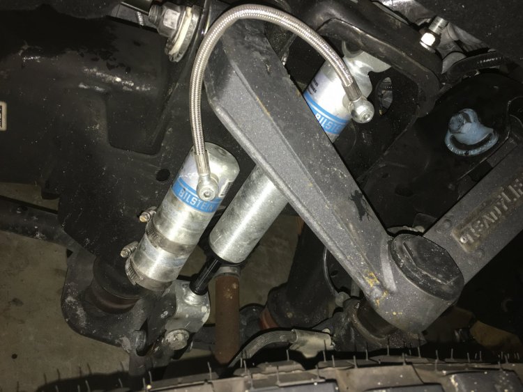

You, sir, are correct. Your'e on the right track. Running skinny 35's with keys, diff drop, 5160's with shock spacer, BDS steering stabilizer, UCA's, rear bags, and a bumper that lets nothing touch. I added the ready Lift UCA's at the end, and they made all the difference in the world for ride. They freed up the front suspension movement, got the alighnment back on track. I get in and out of my truck like 50 times a day it seems, so I don't want a lift, just a little level, and I'm good. Hope you figure out what you want, these are great trucks.

I originally considered lowering the rear of mine but ultimately lifted the front roughly 1.5" (7 turns of T-bar bolt) because I was concerned how airbag might react being compressed more from the get go. I also did the diff drop as well.

The truck has 85k on it so I was going to go ahead and replace the junk rancho shocks with fox shocks, turn the keys up 1.25 in and call it a day.
Unfortunately the aftermarket rims I believe have a zero offset so they're already sticking out a little bit in fact as you can see from the pictures the 265 just about rubs..
