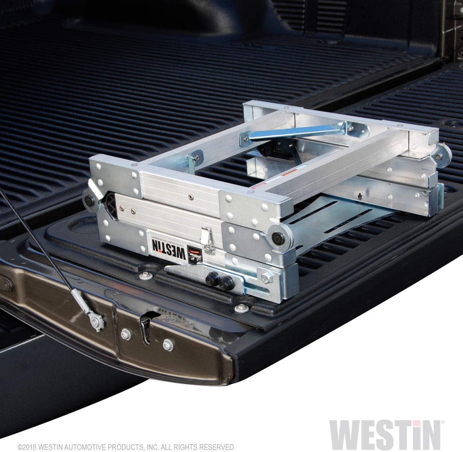

Well I just got around to installing the EasyLift.  Way easy to install.  Only had to drill one hole because the hole for the wires running into the tailgate worked perfect for one of them.  What a fantastic mod!  The gas spring keeps it from slamming down and now I can put it up with one finger.  Easy peasy.  Next up is a ladder.
