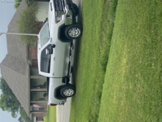

ps. Only pic I have since I put the leveling kit on. Tires being installed as we speak! (No clue why it’s sideways!)
