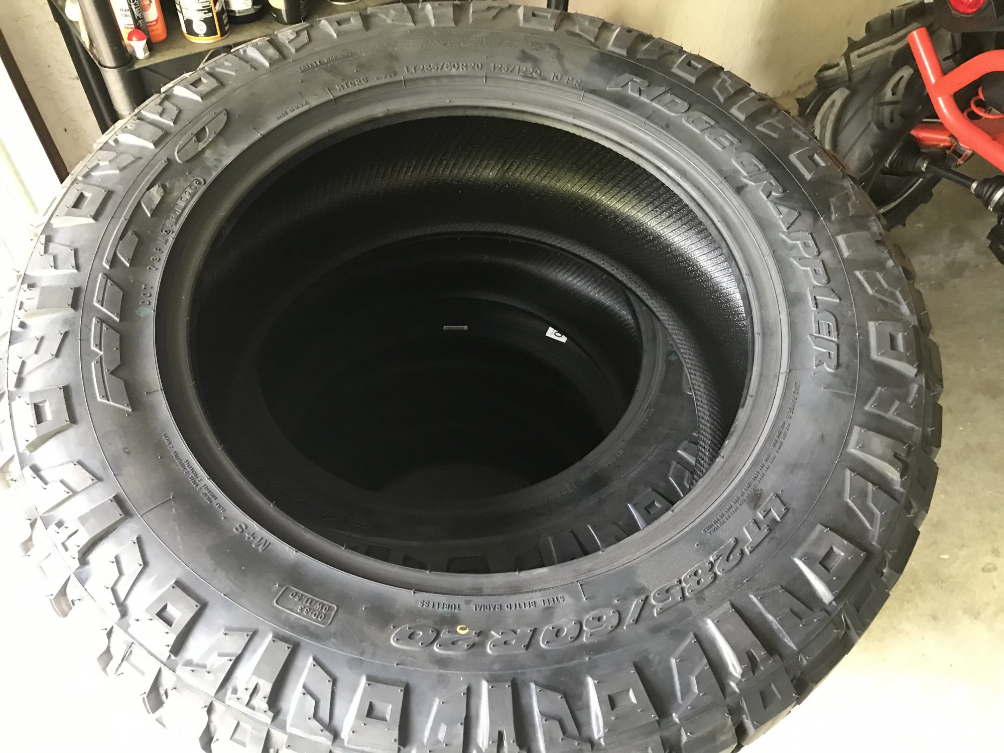

I currently have the Bridgestone Duelers and I very much prefer a stock look so I will not be changing the wheels and/or tires out.  Once the Duelers wear out, I'll most likely go with OEM replacement or a variant of the Nitto Grappler series in stock, or taller sizing, but not wider.

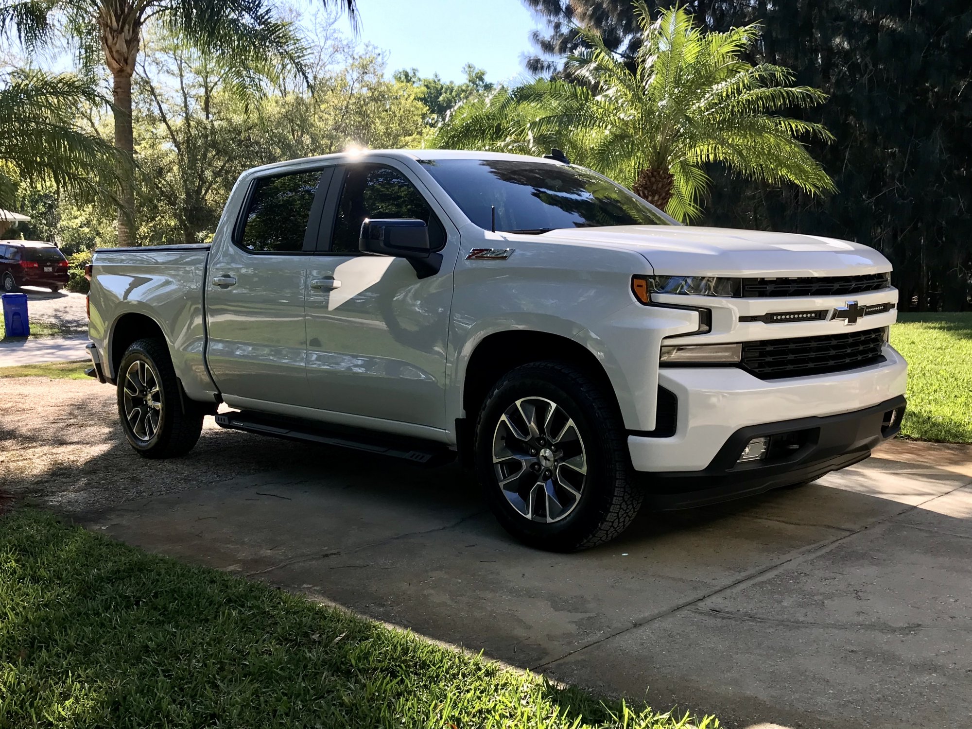

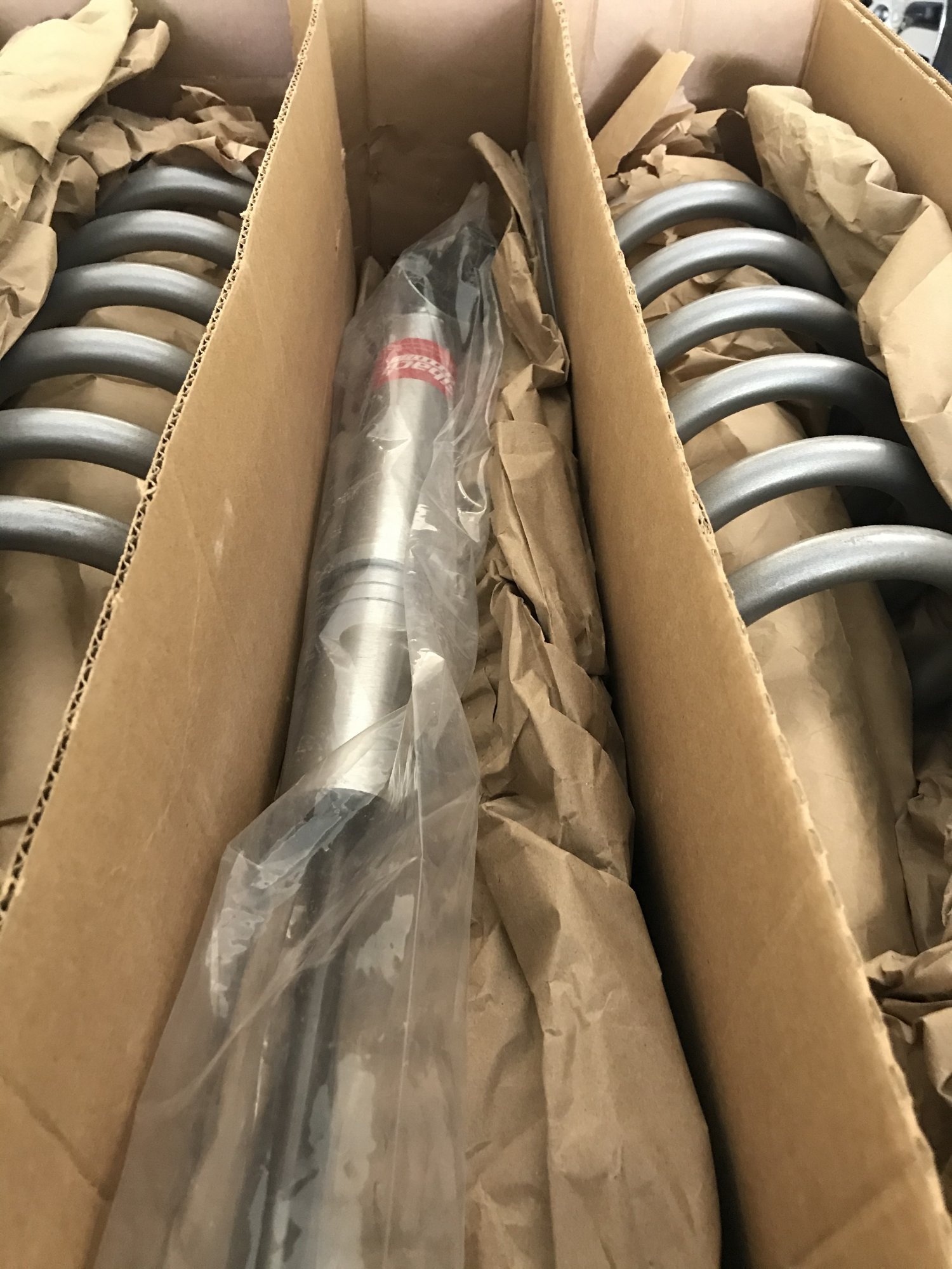

The kit and tires arrived today. Ill try to get before and after pictures. I also had the air lift bags installed when i bought the truck 2019, definitely helps. The truck would squat significantly with not much weight, some what disappointing. The air lift bags took care of that issue though.
Mauricioz771, nice truck!
Please post photos, mine won't arrive until later next week and I'm curious what your thoughts are on the handling.

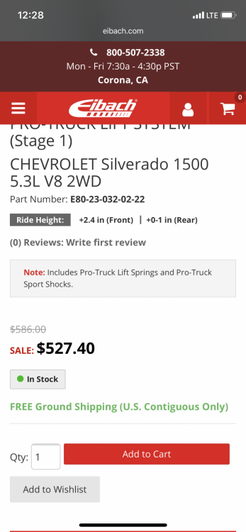

I looked at this kit. Their website says it only lifts the front 1.2” and 1” in the rear. Can anyone confirm?
That is without their spring.  If you get the kit that includes the springs as well as the 4 shocks, you bump the lift up by an additional inch.  Their springs account for the additional inch + making it a 2+ inch lift, but that is variable as well depending on the elevation slot you select on the shock.
