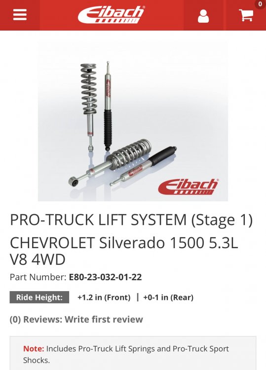

I looked at this kit. Their website says it only lifts the front 1.2” and 1” in the rear. Can anyone confirm?
I believe the rear shocks are good up to a 1"lift  in rear but they wont raise it 1"....you would need a block to get the lift.....or leaf spring kit

Ya, I saw the kit with the springs, didn’t come up under GMC for some reason, 2.4” front 1” rear, I think I’m going to pull the trigger and get a 2” block for the rear and Camburg uniball UCAs.

I actually just realized that the 2.4” lift is for the 2wd. 1.2” is for the 4wd. I sent an email to Eibach to see why they’re different and also if you select just their single rear shocks they’ll accommodate 1.5” of lift.... but their kit says 1”..... wtf

I sent an email, but their website has a 2wd filter and a 4wd filter, 2.4” front lift is only available for the 2wd model, the rear Pro truck sport shocks in the kit say 1”, by themselves they say 1.5”, the struts w/o springs say 0-2”, the springs by themselves say 1.2”. If you dont believe me just ask me lol. I’ll wait for Eibach’s response. Both kits include springs, I spent a good hour going through their filters for both Chevy and GMC. Could be they mis printed the spring lift for the strut lift on the 4wd. Either Eibach’s website is a cluster or y’all are putting the wrong kits on lol. I’ll let you know what I hear, I’ll try calling but haven’t had luck with other suppliers. I’m going to be disappointed if this kit only does 1.2” I was pretty excited about it

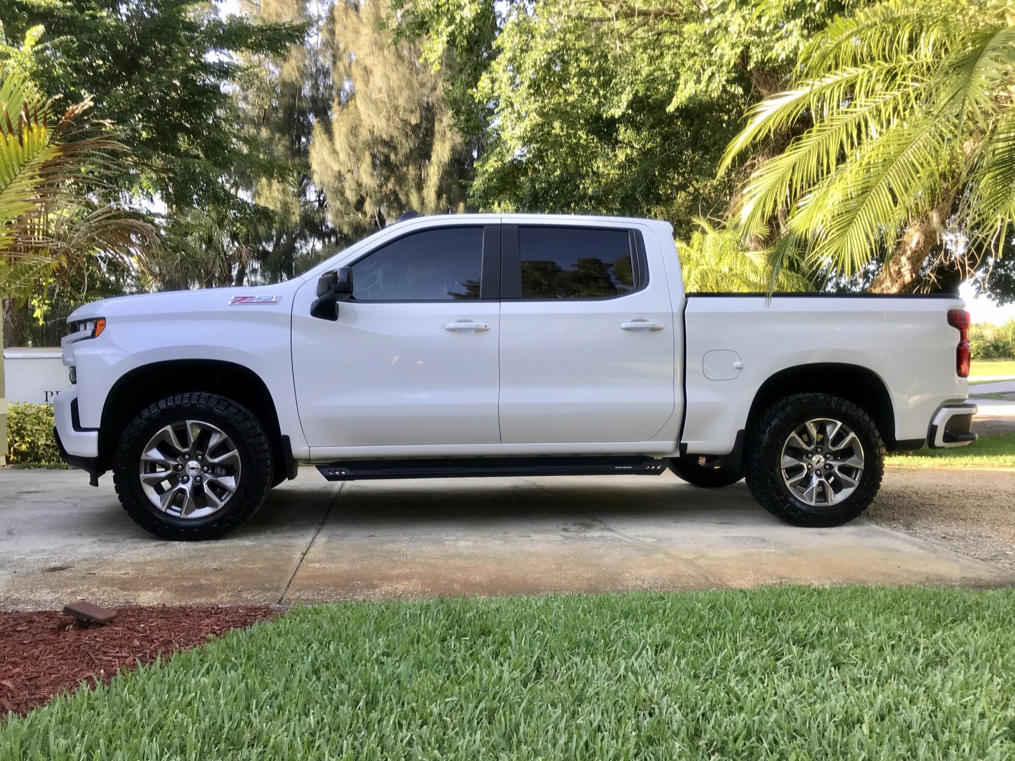

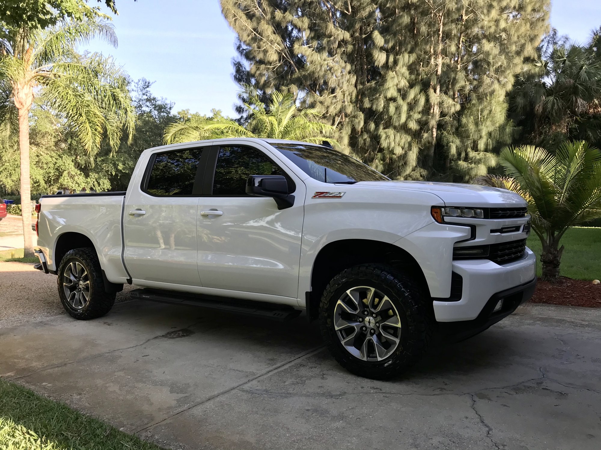

Kit installed! My initial thoughts, the bouncy ride is completely gone. My shop had to call them up to figure out the adjustments, no instructions in the kit or on their web site. Can’t complain though I believe it came out very good.
