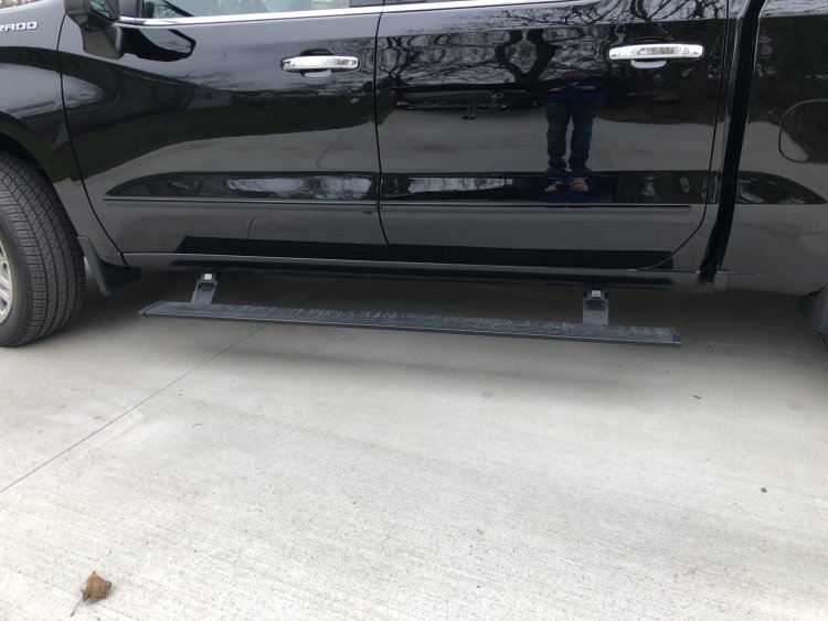

For the back linkage on a crew cab:
Did you you the second to the last set of holes or the first?
I feel like the second to the last (as instructed in the install guide) is too far forward.
Well, it depends. I guess a lot of people didn’t get the holes I used which is unfortunate. My second to last set of holes is placed perfectly. Maybe 6” in front of the rearmost holes, and nowhere near as far forward as the ones I’ve seen some people use. That to me just looks terrible.
DB618CD4-CB03-41D5-8C6B-0AA1EFA01784.thumb.jpeg.0ba5064a87615633c0704bd447a993ef.jpegC022778A-0176-44FB-97C3-1EBC72DA0FF4.thumb.jpeg.17c4037451c92c95a60a8bb4b5a3a57b.jpeg
Mine, unfortunately, are at the 33 inch mark but I think that leaves too much step behind the linkage. Think I’m gonna move them to the last holes tomorrow.

Might have to give the cab mount on the frame a little haircut then. The hinge will hit it in the furthest holes.
Dammit I see what you mean.
I wonder why there are variations to the mounting holes. Maybe differently spec’d OEM steps? Mine came with the “fancy” off road style.
No idea...no rhyme or reason to which trucks got what mounting holes, as far as I can tell. Mine didn’t come with any steps originally. For whatever that’s worth.
Been looking at these for a while and watching the install videos. Appreciate the heads up specific to T1s. Will have to check my setup. Sounds like a lottery
I used the last set of holes for my install and the Amp rotating arm did hit the frame brace on both sides. My only other set was 30 inches away and looks terrible.  Used a dremel and cut an angled piece off of the brace and now it clears by about 1/8 inch.
When they touched, they would transmit noise into the truck when driving slow.
Since trimming, nice and quiet.
