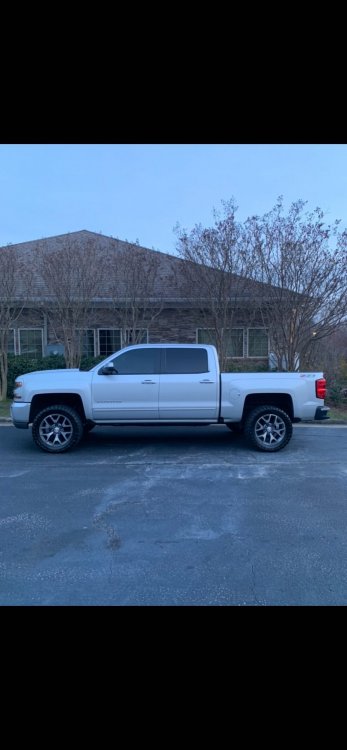

I'll start with my current setup:
2016 Silverado z71 short box
Front - Bilstein 5100 set on 3rd notch w/ 1" top spacer
Rear - Bilstein 5100 w/ stock 1.25" block replaced with readylift 2.25"
33x12.50r20 w/factory wheels + Bora 1.75" wheel spacers (slight fender liner rub at full turn)
Fender measurements are 39.75" front/ 40.75 rear
I'm planning on moving to the superlift 3.5" kit, so I can utilize the new moog UCAs and diff drop and keep my bilsteins.

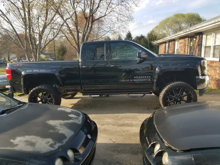

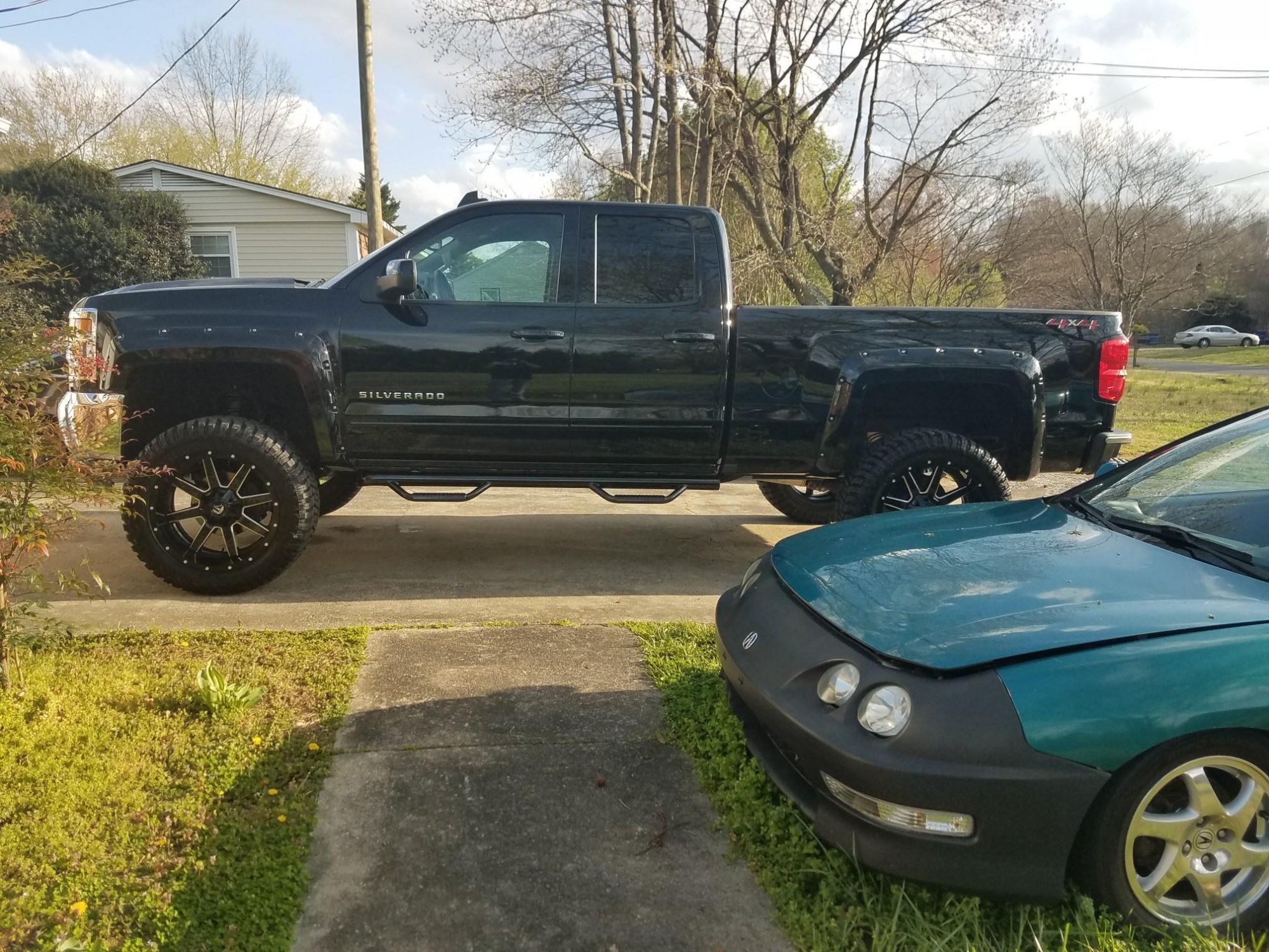

2019 LD 1500 double cab 6.6 bed
7" rough country (full struts no spacers)
22x10 fuels with 35x12.50s
45 inches from ground to fender front and back
29 inches from center of wheel to fender front and back
Slight rub on front bumper backing up and turning
Barely kisses back of fender backing up and turning( could possibly be my fender flares fault not sure)

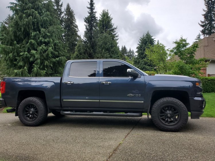

2018 1500 LTZ Crew Shortbed
275/70 r18 Nitto Ridge (33.2 x 10.8)
Fox Coils PS2.0 (+2.5") + 2.25" blocks in rear (+3/4")
FrontR - 39
FrontL - 38 3/4
RearR - 39 1/2
RearL - 40

Love that anniversary blue! It's funny how these trucks work. The 3rd bilstein setting states "average lift" 1.26, so logic would say, I'm technically 2.26" front. We also have the same 2.25" block in the rear.
Your's should technically be close to .5" taller than mine in the front, and the same height in the rear, yet mine sits roughly 1" higher all around. Maybe I got more out of my 5100 than advertised? Maybe slightly different components from the factory? Who knows. Virtually unnoticeable difference, but still interesting haha.
Yeah. I measured a stock Centennial on the dealer lot and another I came across at work. They both measured about Rear - 39 1/4 ; Front - 36 1/2. So the ReadyLift rear block didn't get me the full 1" lift I was expecting (39.25 -> 39.85) (might be because I now store about 200lbs of stuff in a rear box), and the Fox coils that advertised a 2" leveling, gave me closer to 2.5" (36.5 ->39). Which is why I actually got the rear block, since it sat "a tad too level". The measurements also seem to change 1/4" just based on when/where I measure them.
If I do it again or wear out the Foxes, I want closer to 40-41 all around.

Yeah I’m definitely with you there. Everything really is a guessing game. Ive got the same readylift block and I dont think I got the full 2.25” either. I’ve also heard of people with bilsteins on the top level that “should” get 1.77” getting closer to 2”. I think 41-42” is the sweet spot to fit 33x12.50 without rubbing.
