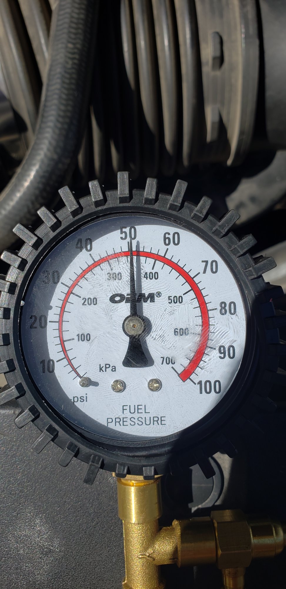

So I tested the voltage at the cam sensor connector with a multimeter and got 11.6V (Checked battery at 12.5V) a voltage drop of .9 volts could this be it? I looked inside the loom up to where it meets the rest of the harness couldn't see an broken wires. Confirmed still throwing the P0342 Cam Sensor code. Skeptical of the accuracy of the harbor frieght fuel pressure tester so I rented an OEM tools one and tested it in the parking lot. Got 50 psi this time, harbor freight reading was 48psi. Truck started and drove fine the 5 miles there and back.
