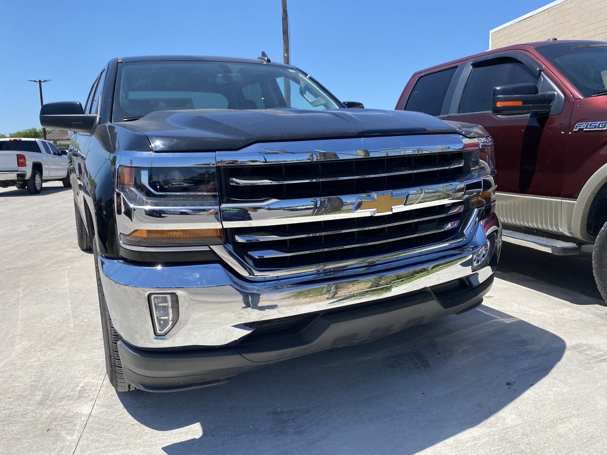

Also Frankie is right that's a High country grille
The LTZ grille zig zagsb77fef35c559b4d99a81c4bbbd52f138.jpgfb52203654e255f2216c30dd3490feeb.jpg

also this is the LTZ GRILL

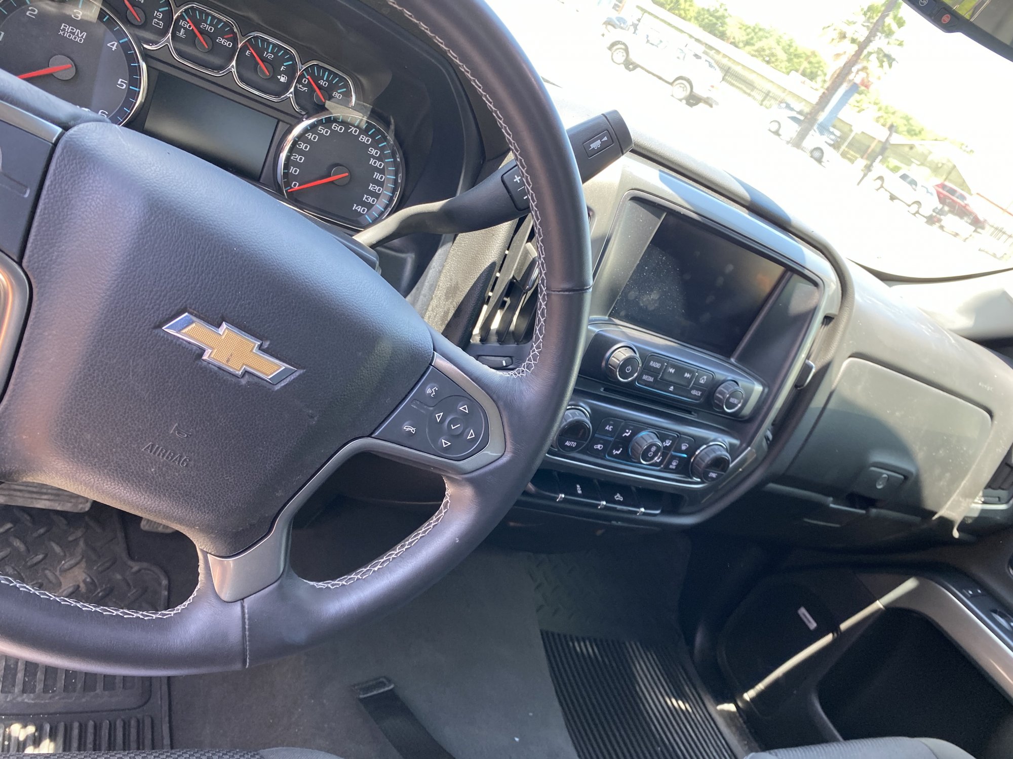

My real concern is when you first turn it on , it has these warnings like “steering assist reduced, drive with caution” ; something about safety restraint (maybe something to do with the air bag?). Are these sensors that can just be replaced.
oh and the steering wheel has to be held a little to the side. I was thinking just a wheel alignment

Please don't buy this truck. It has issues. Lots of issues. Look past the shiny paint . This thing was in a front end crash . The steering wheel isn't straight. There's your first clue. Like I said the grille don't line up right. All the warning lights.
C'mon man. Sure it can be dealt with. Is that what you want to do?
Frankie's truck was a rear side hit. I could deal with that. Not a front end crash that someone is trying to cover up by not reporting it to Carfax.
Keep looking. There are lots of trucks out there undamaged.
