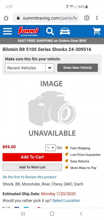

Where did you get them and how much?  Easy to do?
I got them from Summit for $200 shipped. Very easy install. 21mm wrench and socket can have them done by hand in 30 minutes easy. Didn't jack up the truck, just used some strength to compress the shock from the bottom for the install. It's only 4 bolts total.

Which part number did you use?  I have a Z71 that I installed the Trailboss GM lift onto, so I'm assuming the 5100's you used would work on my truck also.
I would assume they'd work since you essentially have a Trailboss.
