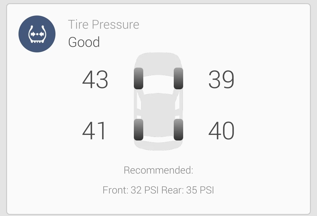

Picked up a 2020 6.2L RST Z71 All Star, Leather, Sunroof, etc... on Monday.  Noticed the PSI in the app was higher than the door sticker.  Thought the ride was going to be bouncy as my LT would bounce more when I had over 35 PSI.  Drove fine on the 500 mile trip home.  Should I correct the PSI or just send it?

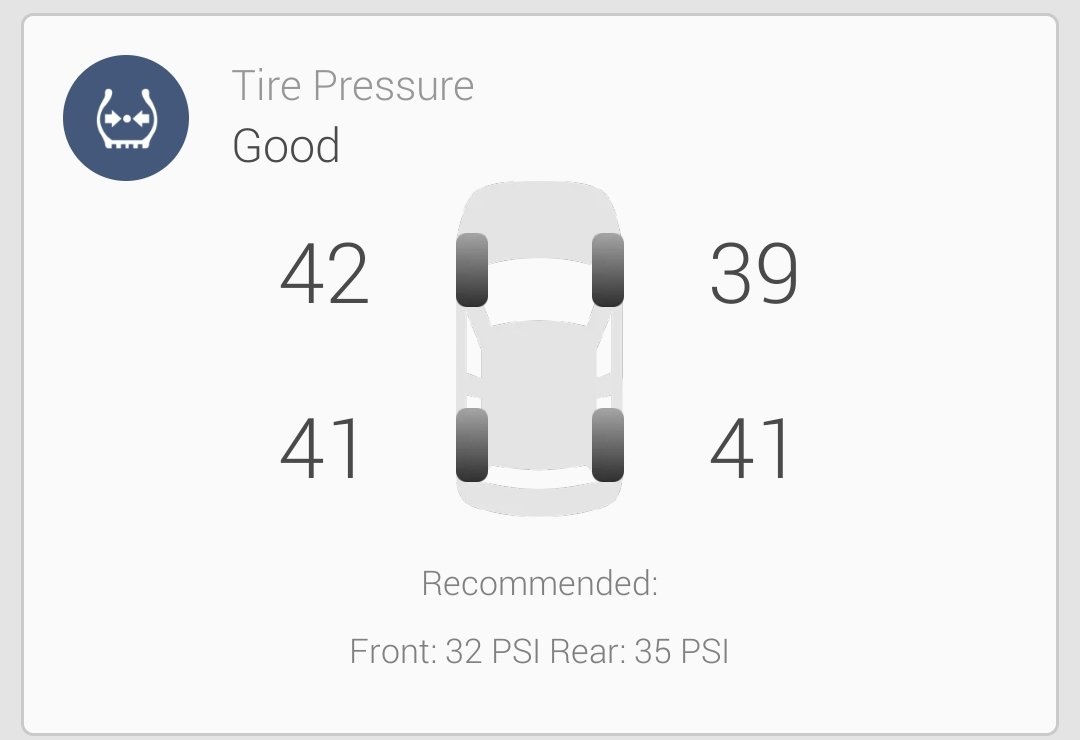

Thanks, I should have mentioned this is the cold PSI.  Truck had been sitting for over 24 hours.  Checked again just right now (truck hasn't been driven and it's 5:30 AM) I also made sure to refresh the app so it would pull the current values.

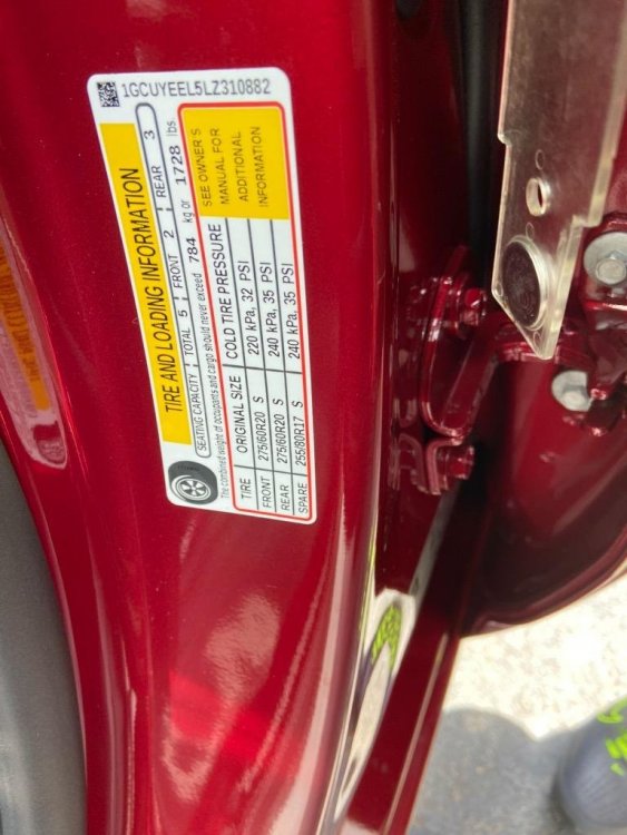

So, stick with your door sticker #s and not the app.

Okay that said tire pressured is set by the manufacture for a specific contact patch profile, both static and dynamic, to work in unison with the alignment specs and parts selection to maximize it's efficiency.  Latitudes are discussed in  your manual. Note that your sticker has different front and back pressures? There's a reason for that.

Door sticker is recommended pressures for the tire size it was born with, and when the truck is a max load.
If it's a daily driver, and not running 'loaded' you may be able to improve ride by reducing pressures a little.  Especially the rears.
