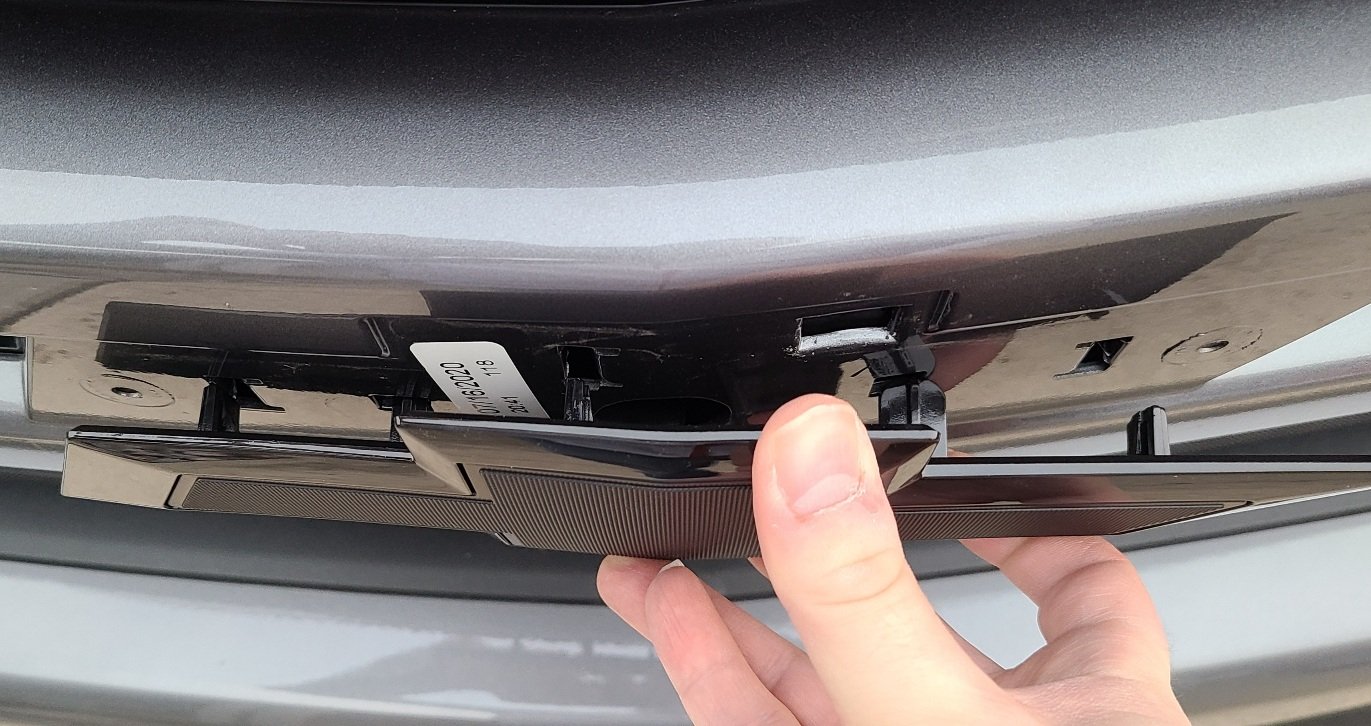

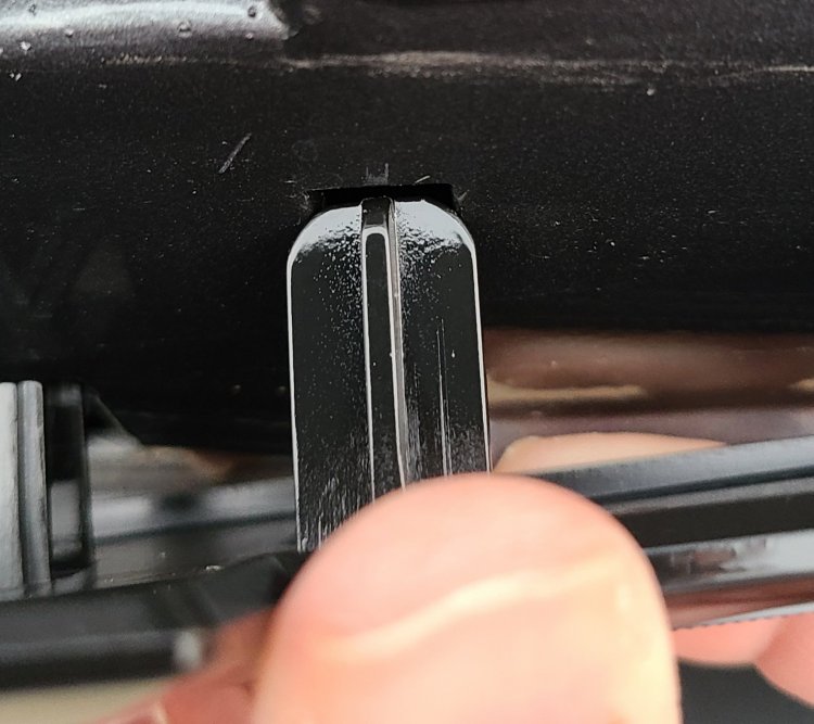

They do not fit.   It should be noted that this bow tie set is for a 2018 and down......NOT for the 2019 up.
Its slightly smaller....and the tabs do not line up from end to end and one of the tabs is too wide to fit a placement hole.  It could be shaved down, but again, from end to end the tabs (clips) do not match.  The bow tie itself is about 1/4" shorter from side to side and top to bottom.  And the two outside tabs are about 1/2" longer than the receiving holes on the grille.
Also...the chrome bow tie from the 2019 and 2020 is exactly 4" high and 12" wide ....right on the dot.   BUT, I can report how easy this one comes off with trim tools.  Just work from one end carefully....I had it off in 20 seconds.
So until Chevey comes out with an all black one, or an aftermarket one comes out, we are stuck to plasti-dip.

I thought about cutting the tabs on this one....and gluing it on but even the curvature angle is different!!!   Total bust.
