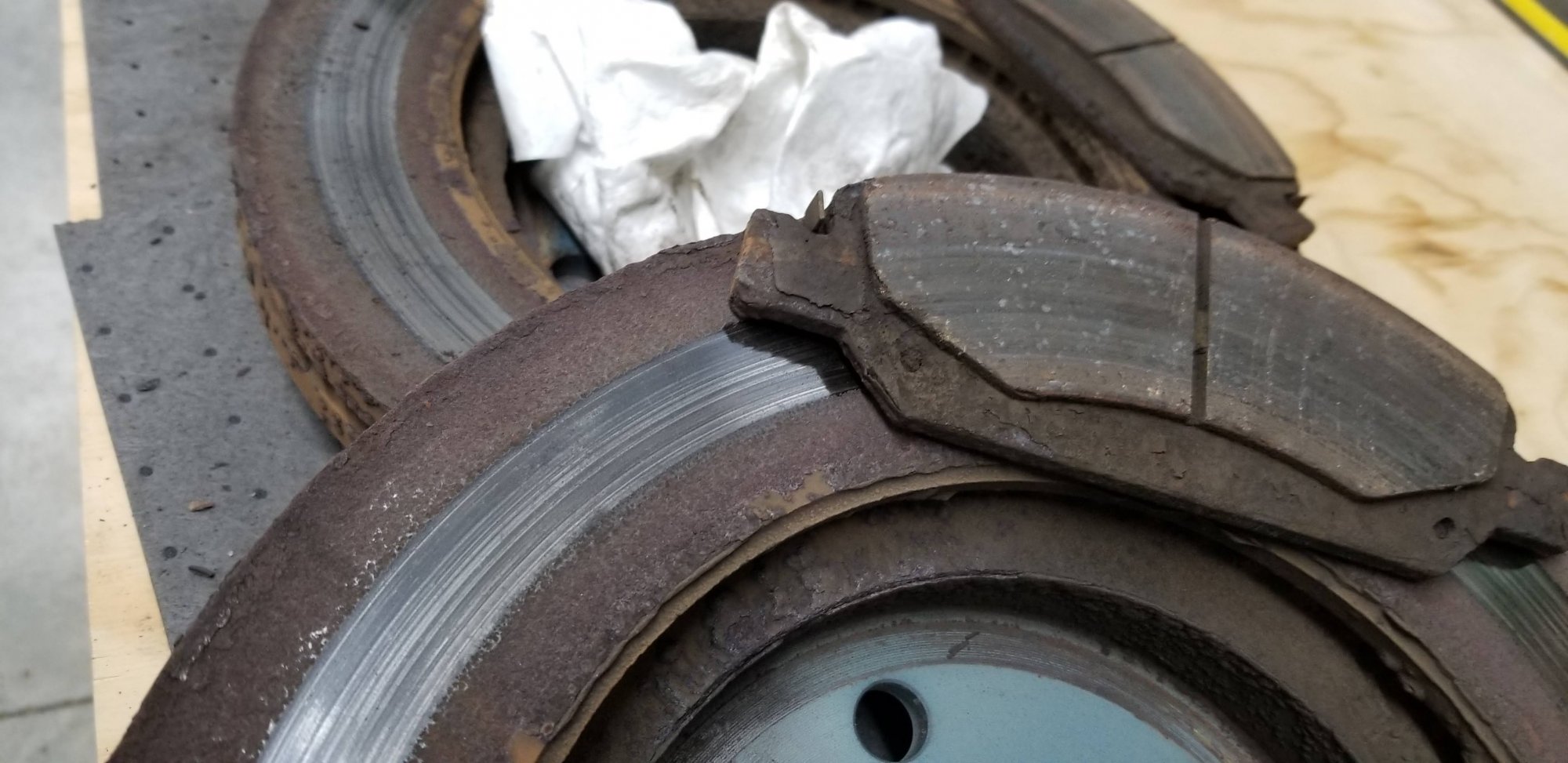

Speaking of GM rotors, check out this wear pattern!
