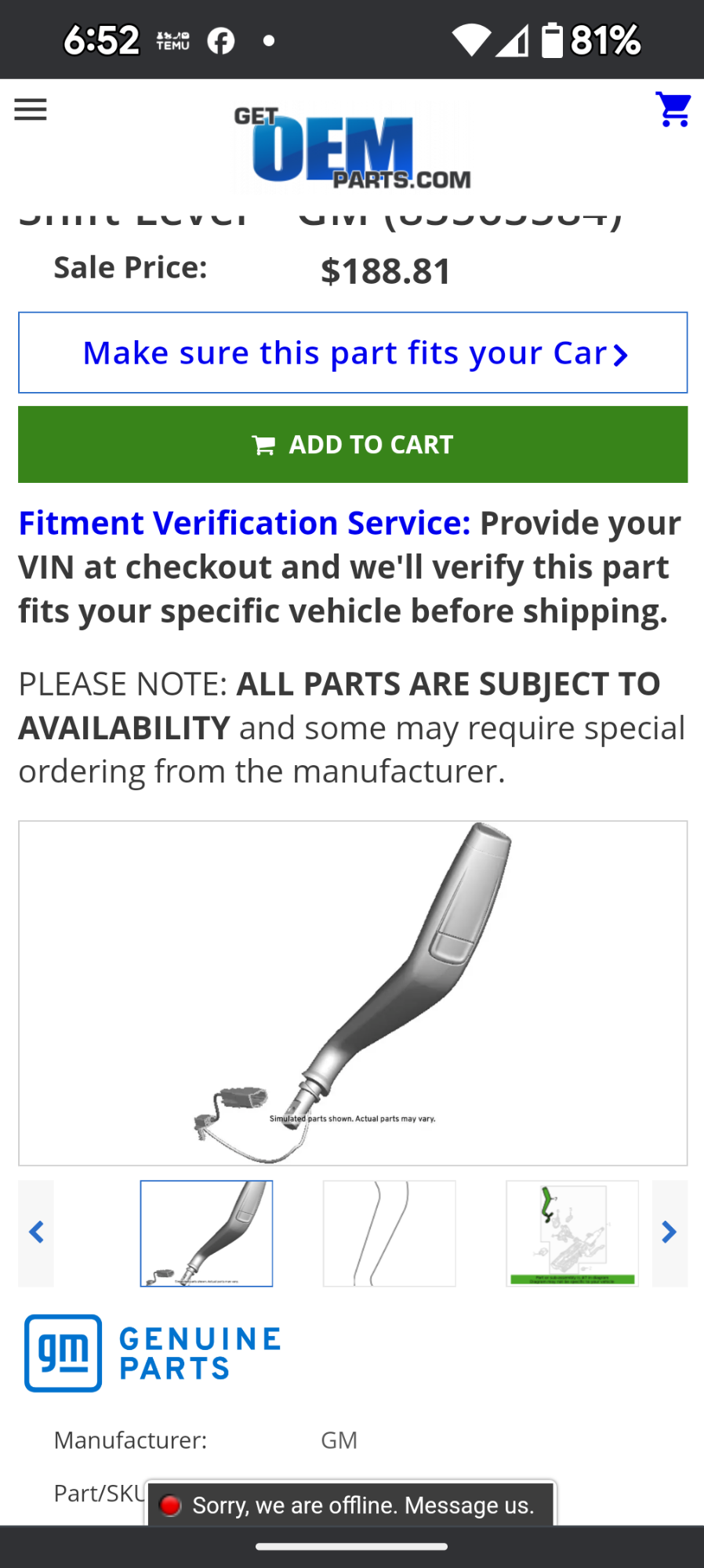

6 hours ago, Rodney Munoz said:
This was happening to me and it ended up being the shifter I had to replace it cost $580 mechanic did it
The actual park, reverse,drive stick Rodney?

Park switch was replaced and is working as it should. That was December 17th. Haven't had any problems since. Hope this helps. Someone cost me about 500 bucks
Dealt with this issue in my 2023 Silverado HD 2500 Custom for six months and FINALLY found a competent Chevy service department.  Issue was that the park neutral switch was intermittently reading incorrectly not allowing the release of the ignition key.  Installed 87846287 SL-N Solenoid (04053-CT). After replacement key comes out every time.
I am a dealer in Canada.  Bought a 2021 Chevrolet Silverado and found immediately that when I stopped and went to get the key out of the ignition it wouldn't come out.  It was stuck.  If you wait several minutes it will release.  There must be a timing mechanism.  If you keep the key in the cylinder the radio will still run and will kill the battery.  Read this forum and we changed a few parts with out success that others suggested.  We ended up determining the fault is in the shift control.  GM Part number is 8505304.  The part is $296.29.  About 1 hour to install and now works like a charm.
