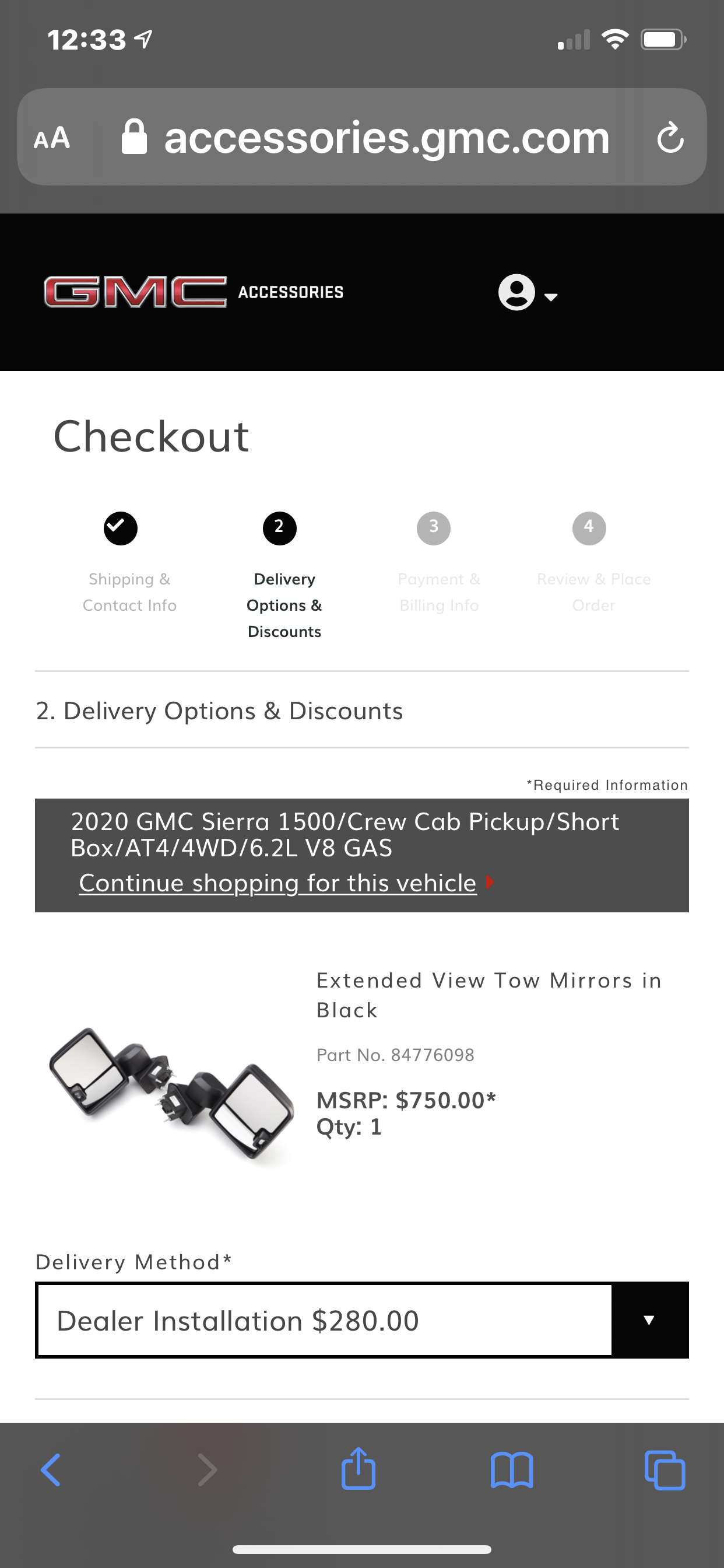

GMC Site says 280$ for dealer install. It can definitely be done!
Little over 1100 with tax, calling local dealer tommorow to make sure this is accurate!
