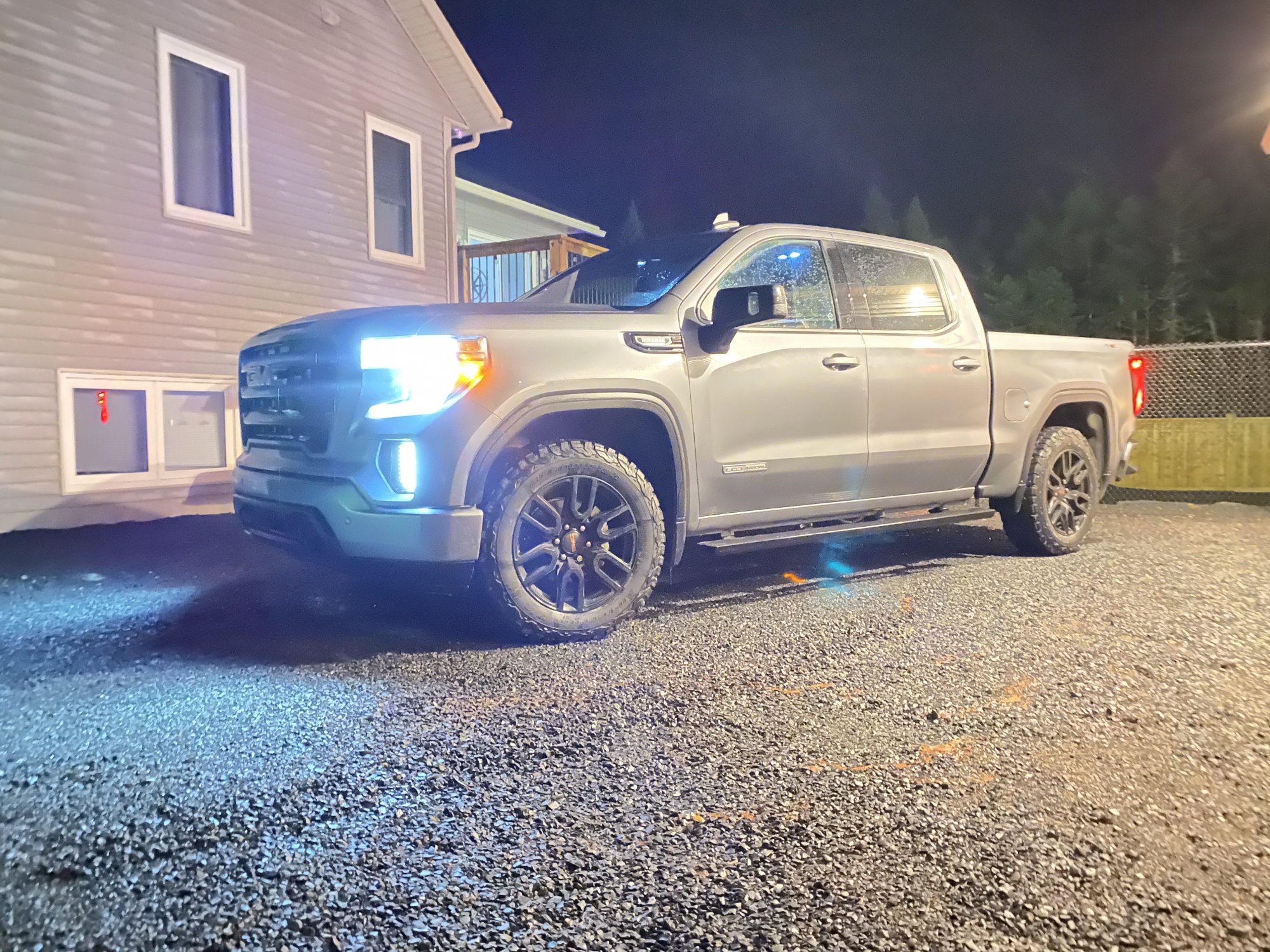

New to the forum and Gmc. Just traded my f150 5.0 10 speed for a elevation 3.0 duramax.
looking at the rancho 3” but would rather another brand of shocks. Bilstein shocks or similar. Anything on the market. I know I can piece a kit together.
what are my options for a 3” lifts?
looking at fuel rebel 6. What off set do the Gmcs likes 1 or 20?
I have fuel coupler from my Ford 20x9 with 1m off set with 33x12.5 open country rt I can try as well.

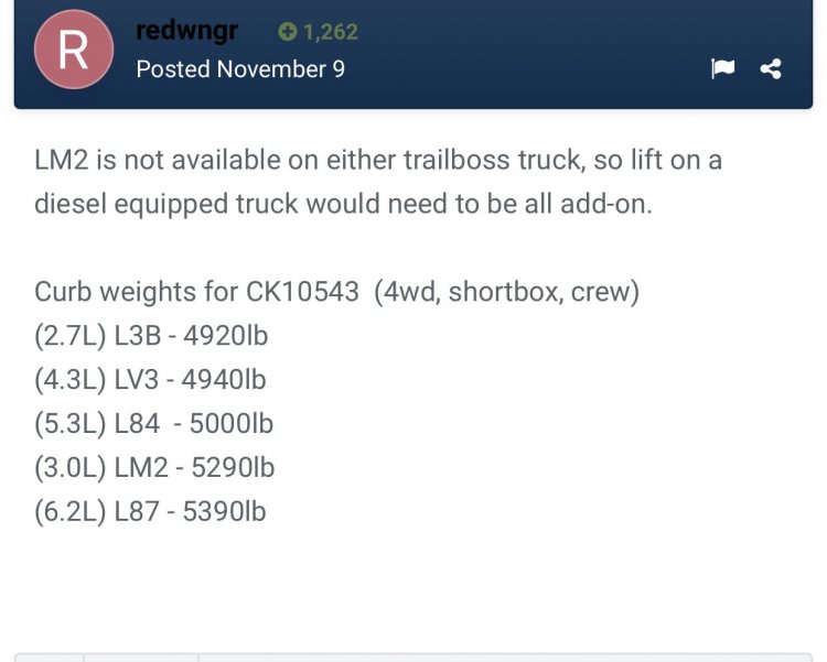

How much heavier is the diesel over the 5.3 and 6.2 ?
Not sure exactly, but you can search this site for a discussion on this. I believe it is approx 200 lbs.  Just make sure you read the fine print on the lift struts.  I correct my previous post, I tried the rough country 3.5 lifted struts, not the Rancho.
The 6.2 is a little heavier then the 3.0 not
by much. But what every they claim for the 6.2 we’ll work for the 3.0.
