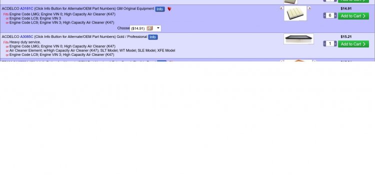

Both filters will fit and "be proper"...your choice as to which one you want to use based on your driving conditions (normal around town/highway driving, get the OEM...off road/dusty conditions, get the heavy duty service...only about 30¢ difference at RockAuto)
A3181C is GM OEM filter
A3085C is heavy duty service filter
AF5314 is another option but it is an economy filter...probably changed along with an oil change at some quick lube joint and owner was charged premium price for it
