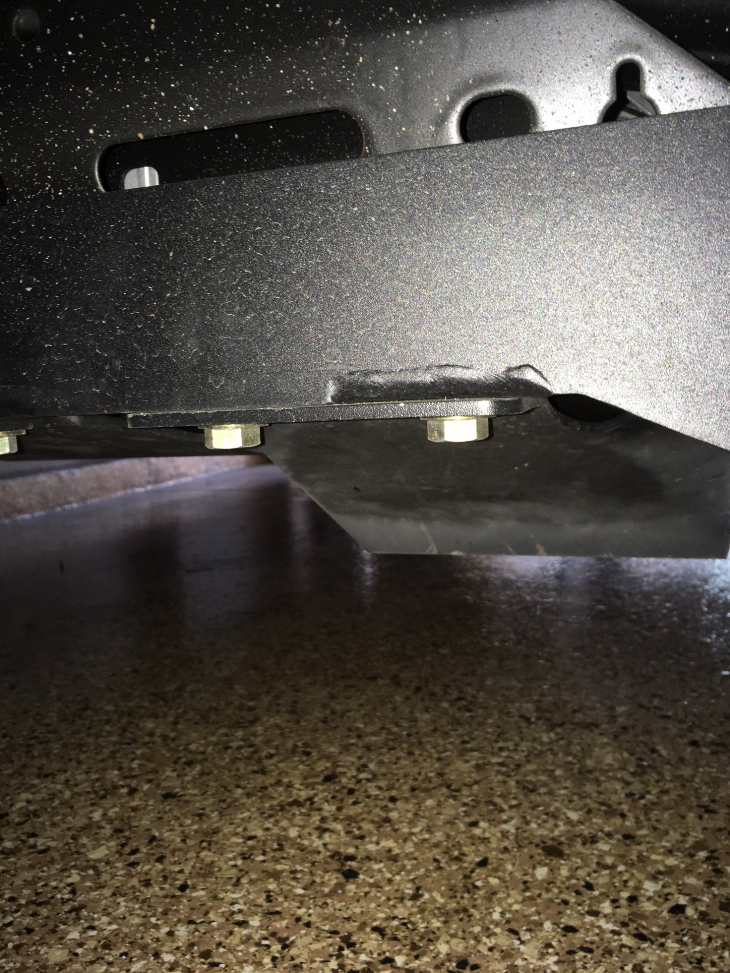

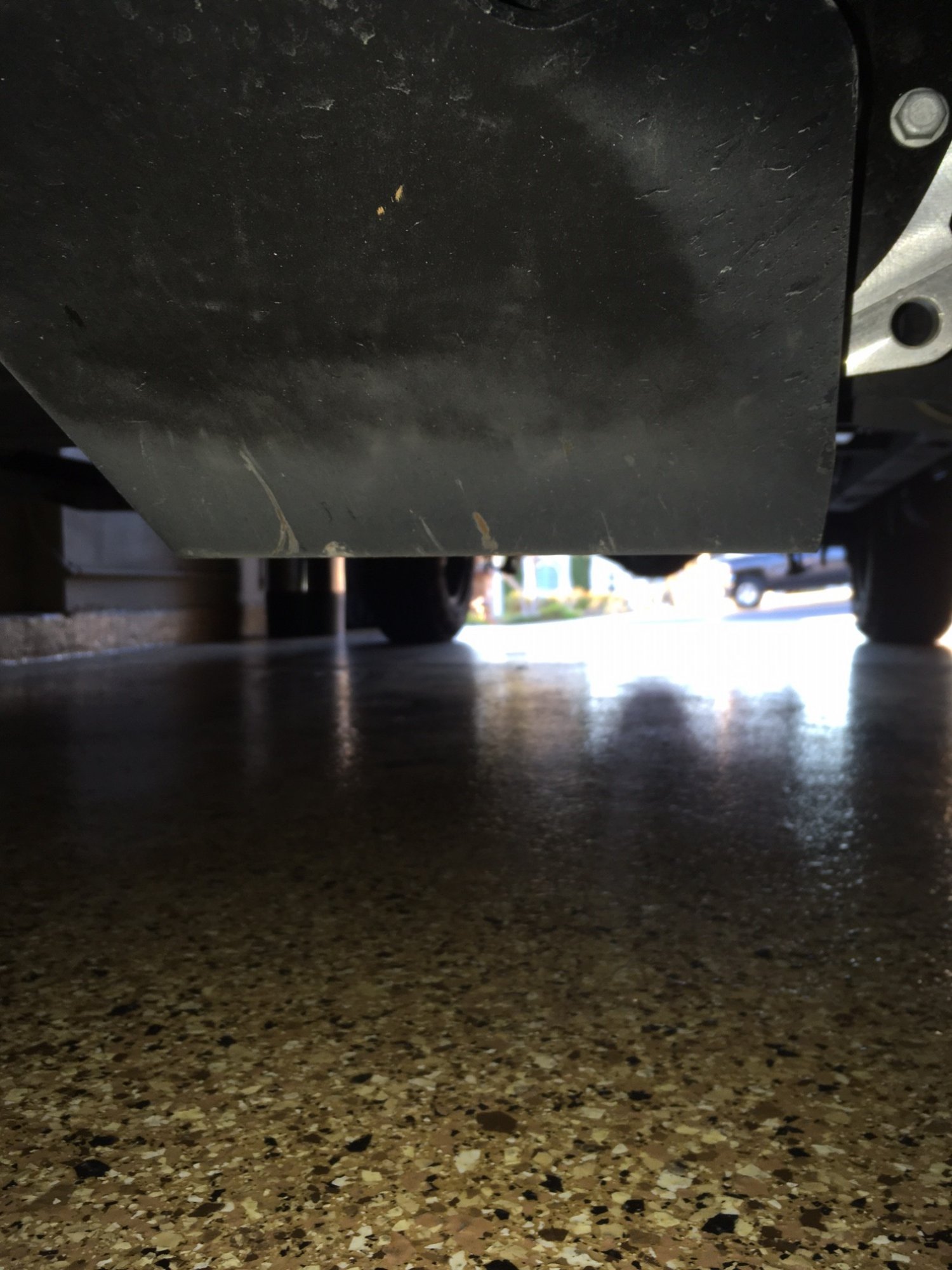

From the ground to the bottom of the diff skid plate is only 8" - that is the low point which is the front edge - it slopes up as you move back.  That is with stock Duratrac 275/65/18's on Method 18x9 wheels.  GMC specs for AT4 front clearance is 10.12" for AT4 and Denali - mnot sure where there measure too but you are giving up some clearance for sure.
As you can see in the photos I have already hit a few things with the skid plate.
I don't think 17's will work - they won't clear front brakes calipers on the truck.  The Tie rod from BDS will interfere with wheel, unless you move wheel out with 0 ot negative offset.   You can avoid 20's but 18's are probably as small as you can go.
Front diff skid plate clearance
8" of ground clearance from front lower edge of skid plate w BDS 2.5" lift and OEM 275/65/18 Duratracs
