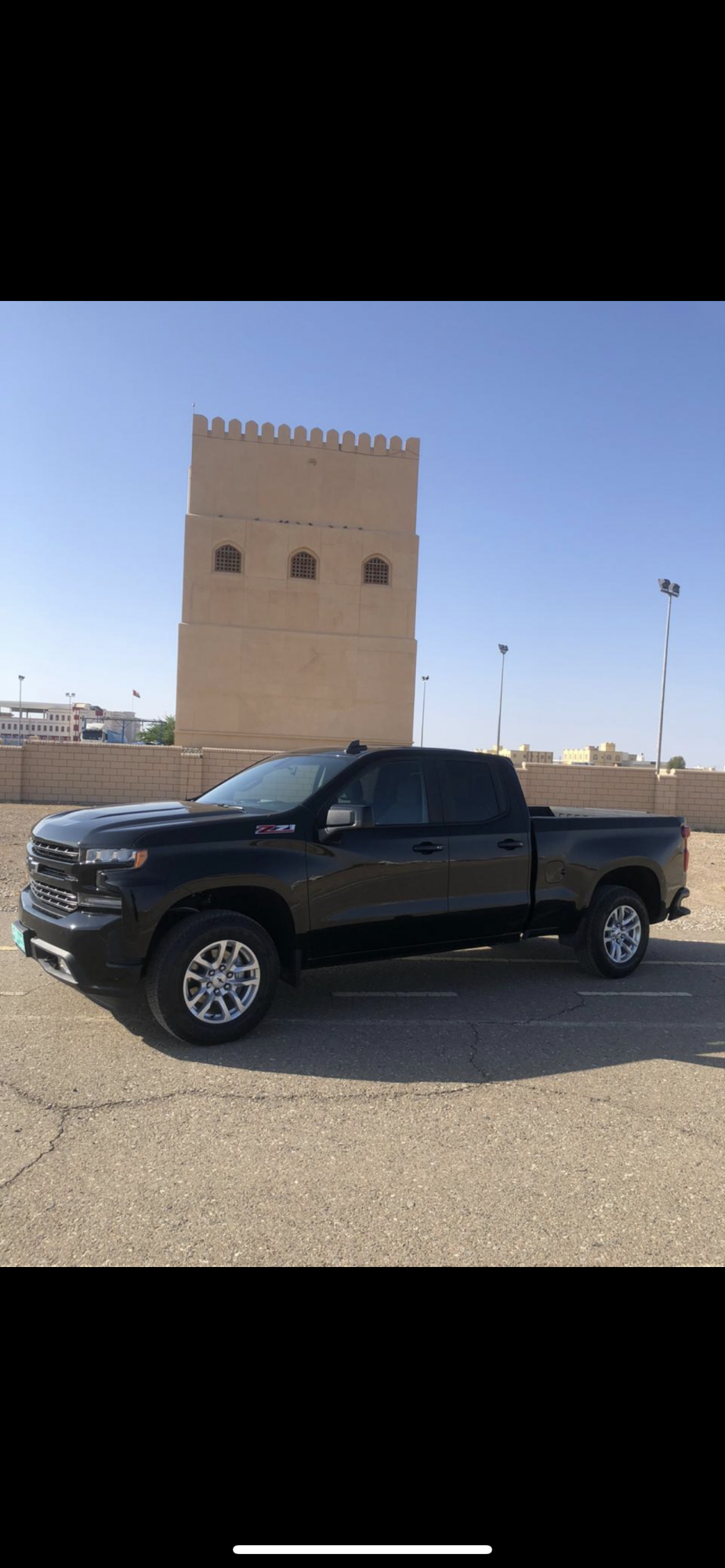

I will take a before and after picture tomorrow. I have put it on the highest setting. That’s why I was surprised as I’ve used these shocks in previous cars and they give a noticeable lift especially on stock tires.

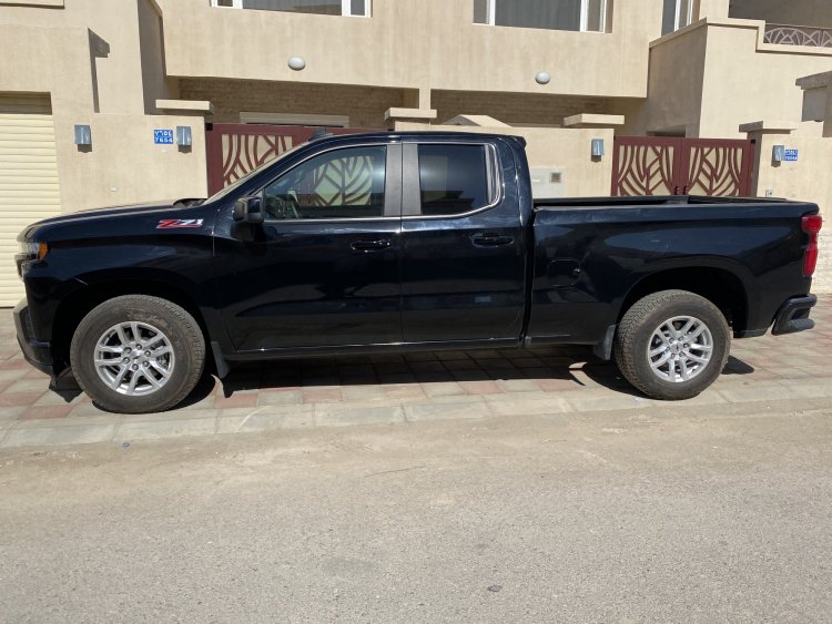

Top ones after. Bottom one is before
Able to take ground to fender measurements on a flat leveled surface ? The first picture with the slope makes it look a bit deceiving along with the color of the truck.
