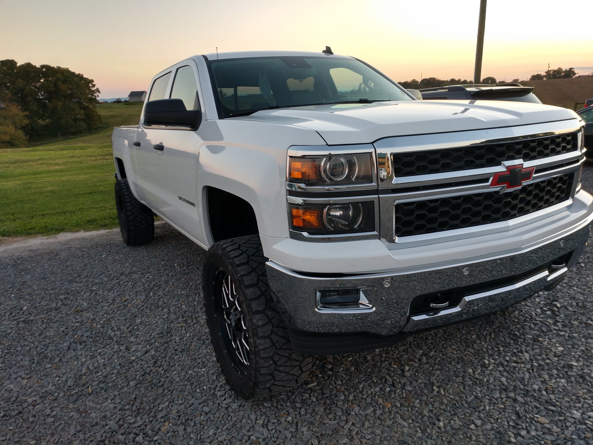

You're gonna have to cut with 6" lift and 12-wide wheels and 35's.  I went with 18x12" and 35's, McGaughy's set at 8" and still had to cut some. Back spacing was 46 so they stick out a little
Edited by nbennettksu

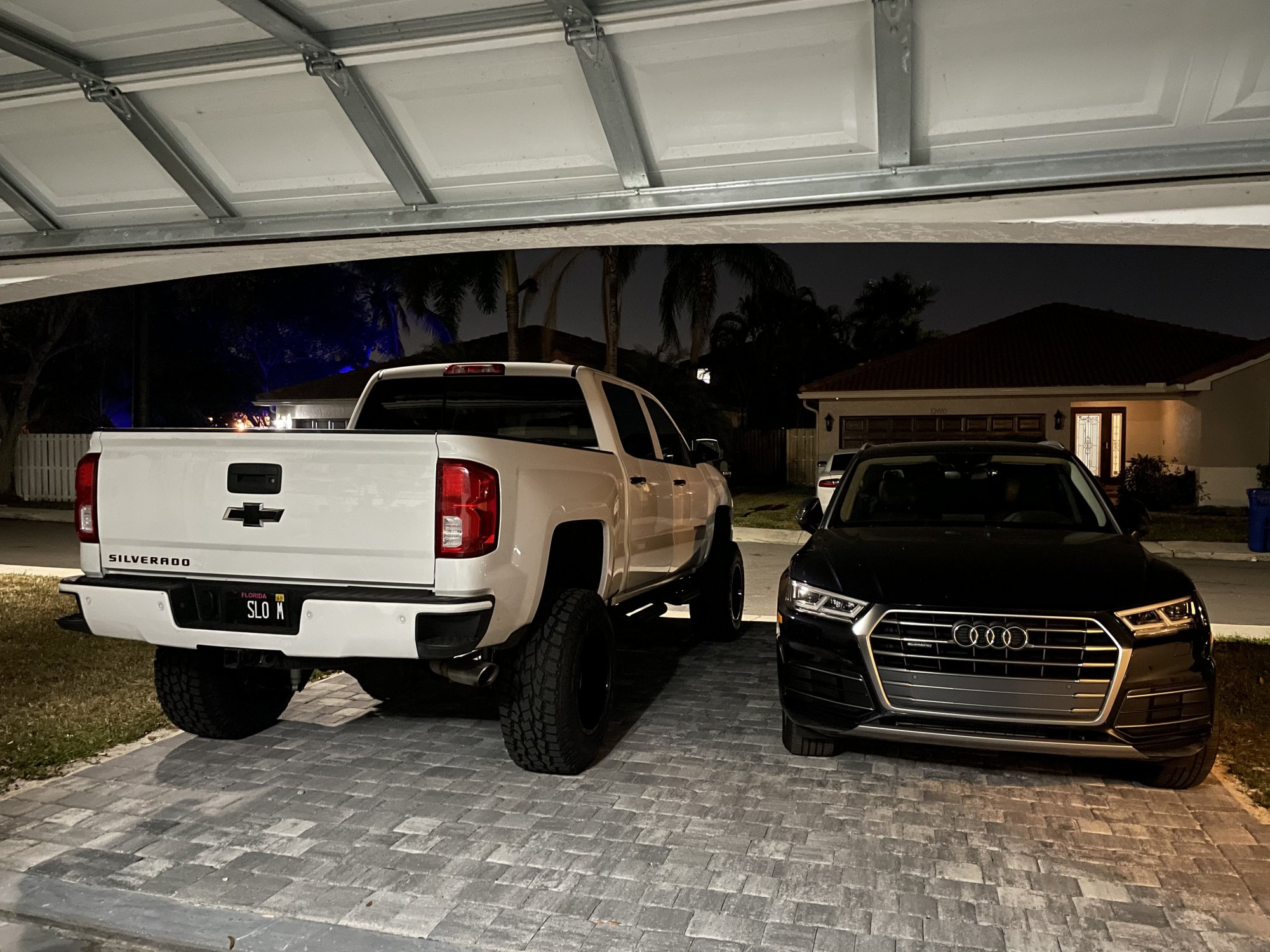

Pic
  • 4 weeks later...
i got the BDS 6" on mine, went with the recommended size from BDS of 22x9.5 on 35x13's... all i can say, don't go that narrow of rim, looks goofy and im already looking for another setup. probably 22x12's. no matter what you do though, the BDS kit will make you poke out.
