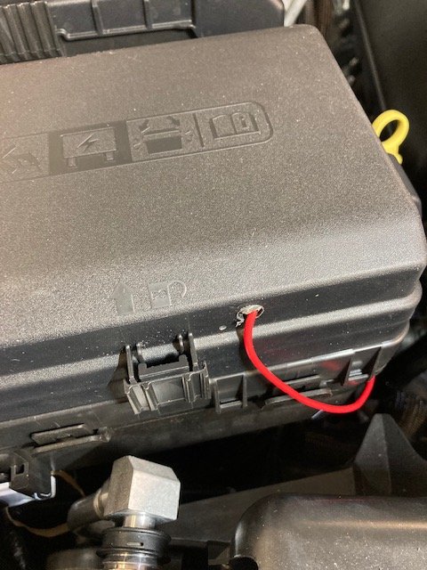

Anyone know of anything I can use without having to tap into a wire?
thansk!

On 3/18/2021 at 10:34 AM, Mac-427 said:
I purchased a fuse tap from Amazon and inserted into position 40 in the fuse box.  I hope the attached photos are helpful.
I don't know how I didn't see this sooner, but thank you! thats perfect!

Hi...
I just tried this and for some reason mine is a permanent feed... very bizarre
On 9/4/2024 at 3:29 AM, Troy351 said:
Hi...
Major electrical system changes for the refreshed 1500's (2022.5)
The other posters have trucks with the previous electrical system
