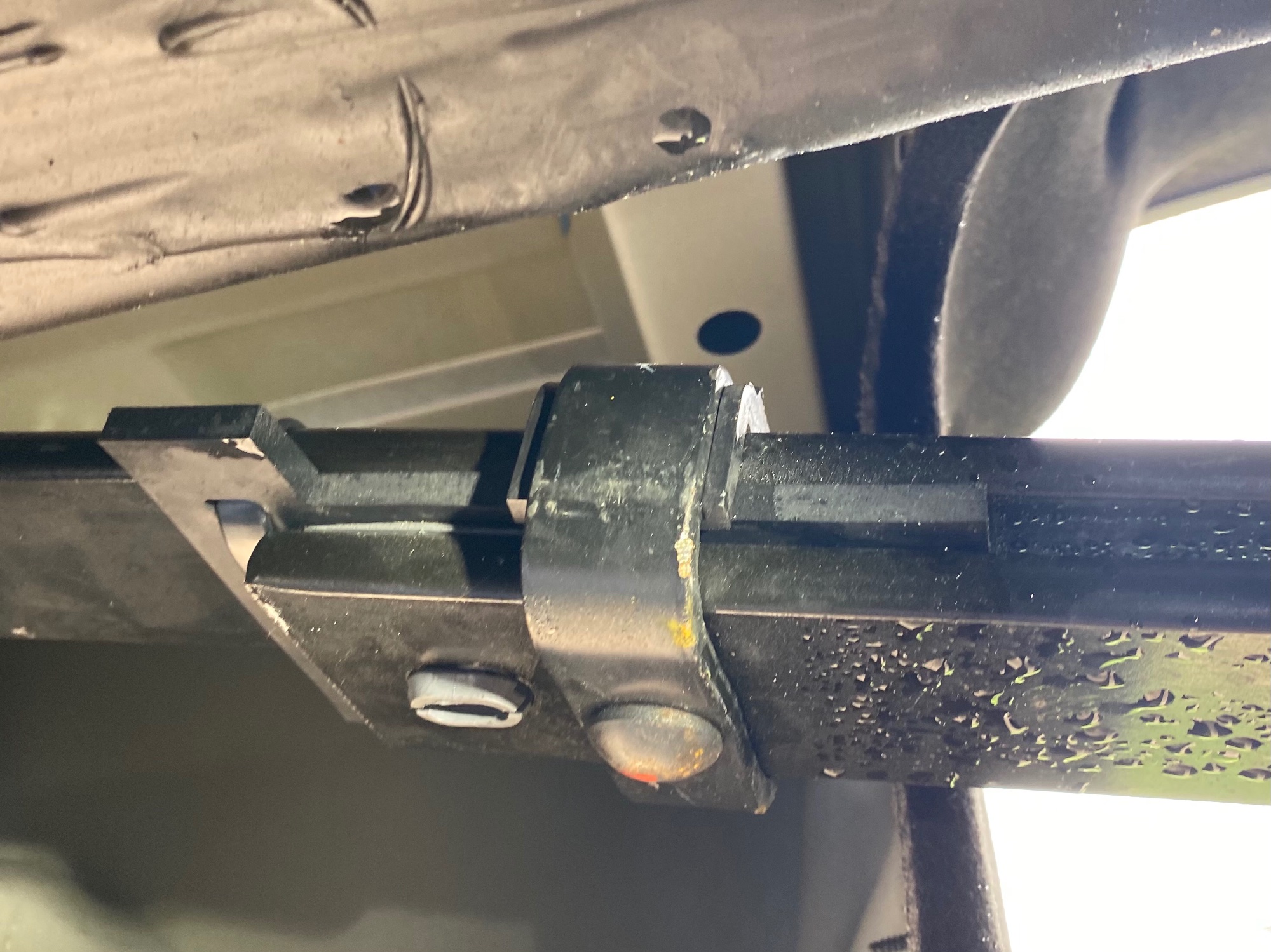

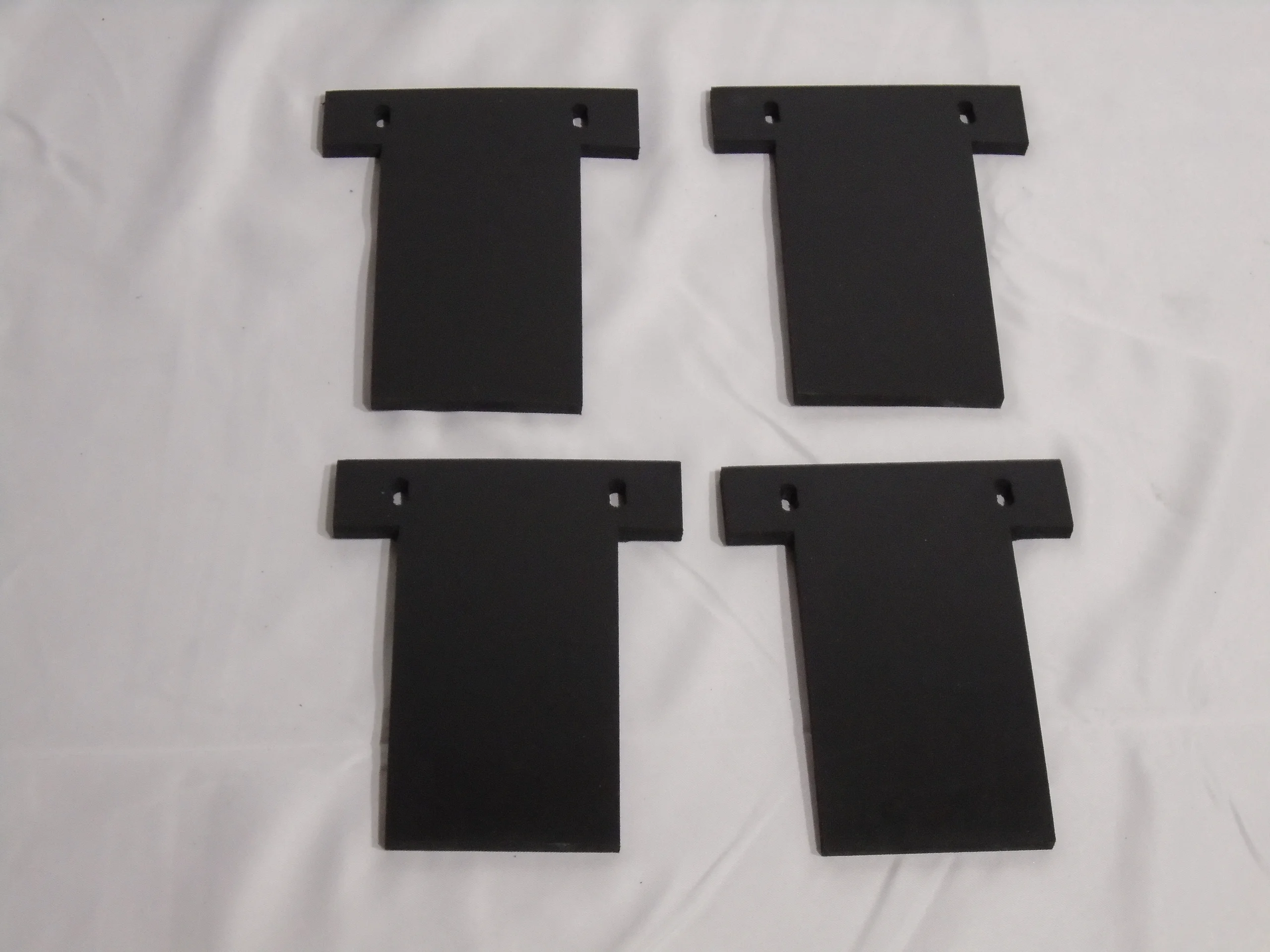

Ok…bought the “Spring Thing” rubber spacer kit. I don’t have  a jack or jack stands so I had my dealership install them . They work fantastic. No more noise at all. The shop foreman actually did it for me. He said their dealership actually had been putting rubber bushings they made a couple of years ago and it solved everyone’s clumping noise. However, GMC came down on them and said to quit doing it and they stopped paying the dealership for the install. GMC is putting these cheap plastic spacers in that don’t work. He said it’s only a bandaid fix. So, I recommend these rubber SPRING THING. Easy install . There’s a video on their website showing it. Here’s mine installed.7BEDD327-B128-4E8F-A8C7-378788138F67.thumb.jpeg.ffde22d679daae42627336625e28d3b7.jpeg
01B7052E-9ADC-4C47-8405-AC6EF91E6CC8.webp E4D40E3F-1B40-4338-870F-BCFF257645BA.webp 995B9B4D-295C-410A-A78B-D2582D49DF90.webp

Check out my last post. Installed the Spring thing kit. No more clunking sounds finally!!
