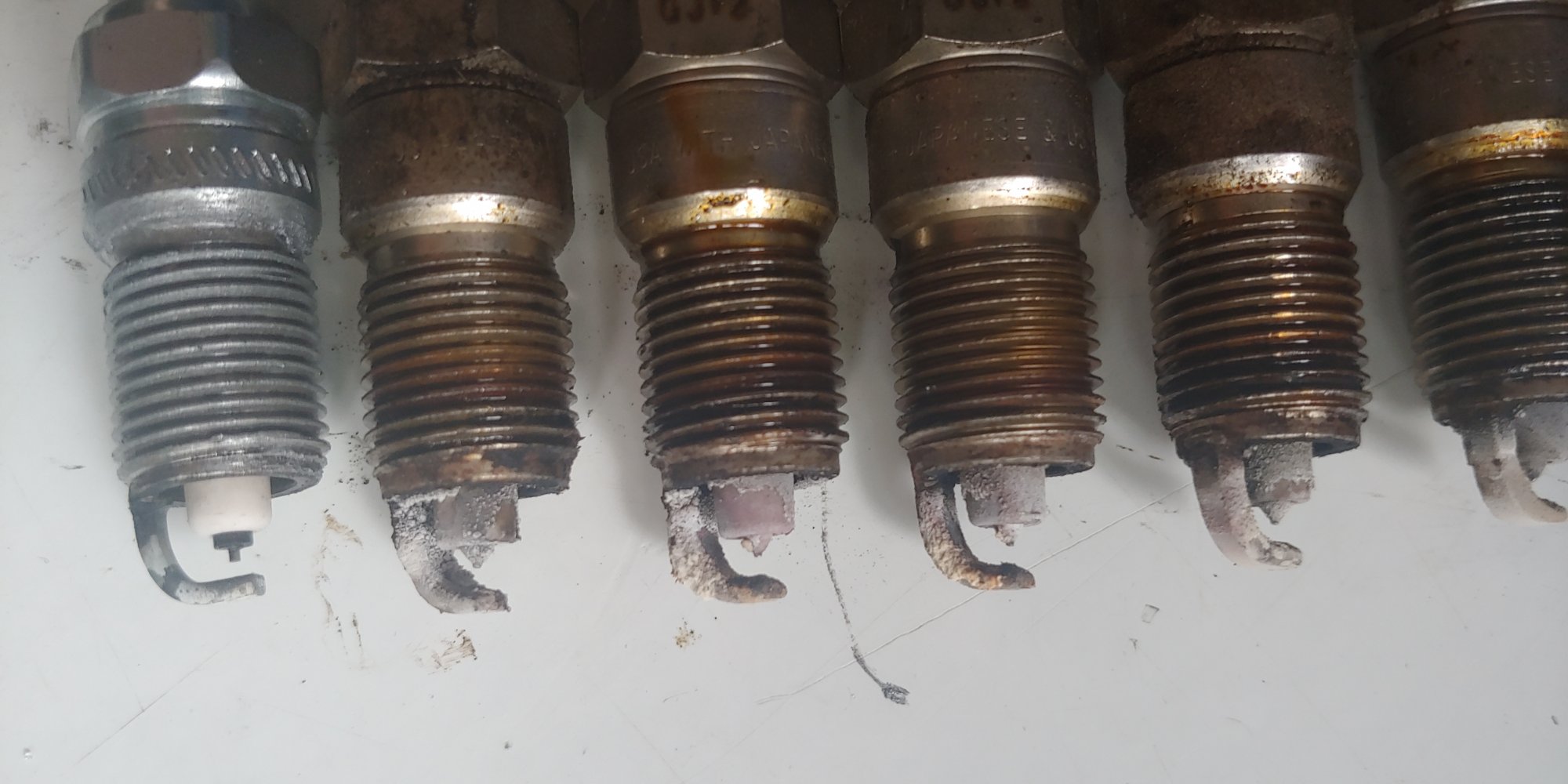

Also, changed the spark plugs. Terrible! The worst one is not even in the picture. But the good looking one was just from 10 miles of driving. I wanted to change it because I had a cylinder 3 misfire-it was before I took it to the mechanic. Now After driving 40 miles no codes came up or no low pressure warning. I did put in a can of Techron in my tank. Will clean the throttle body next.
