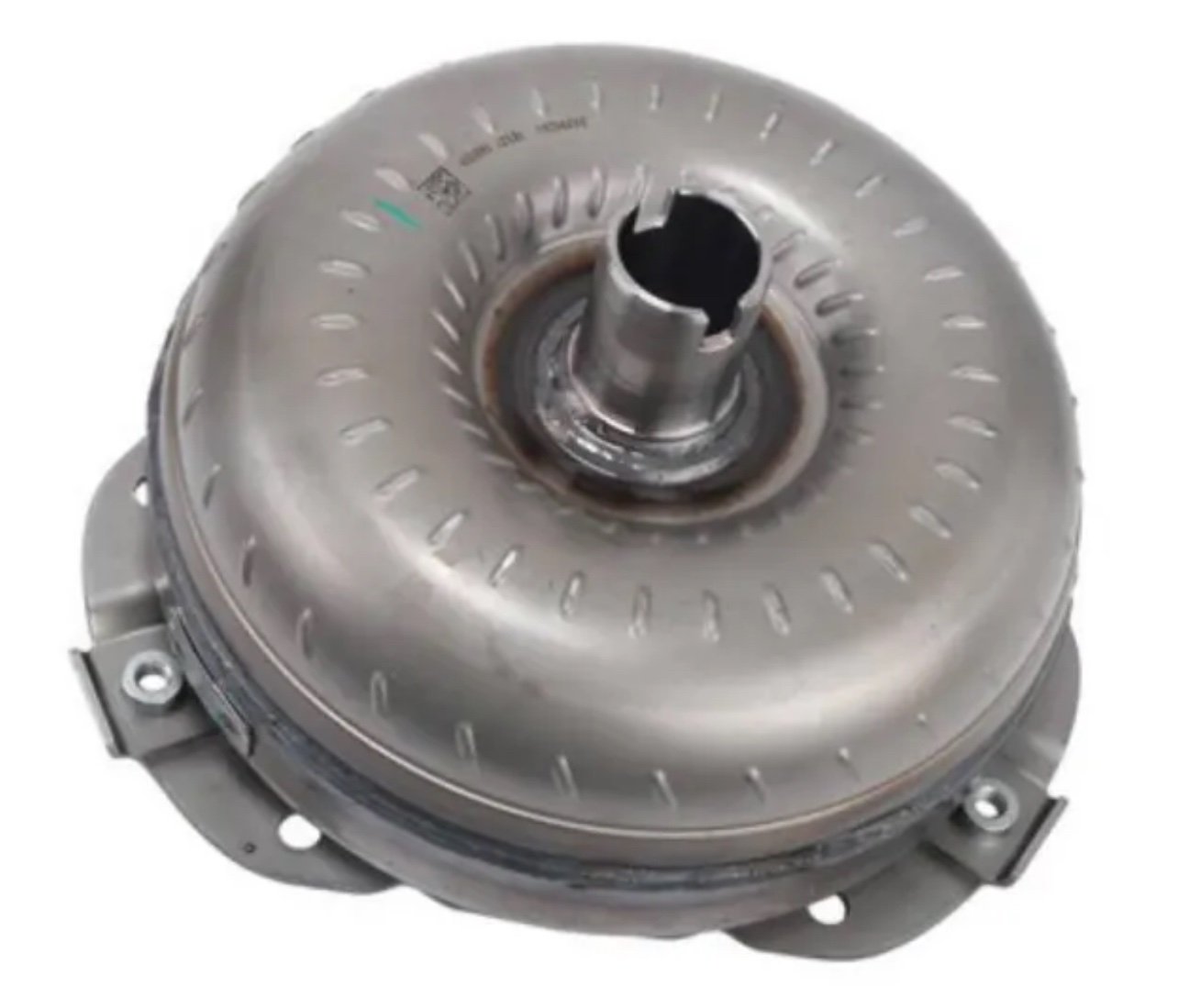

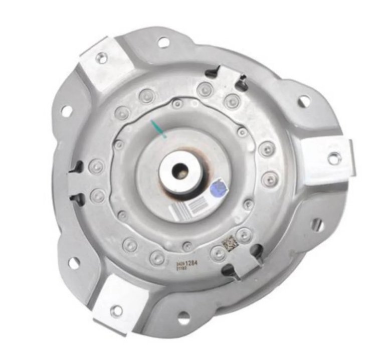

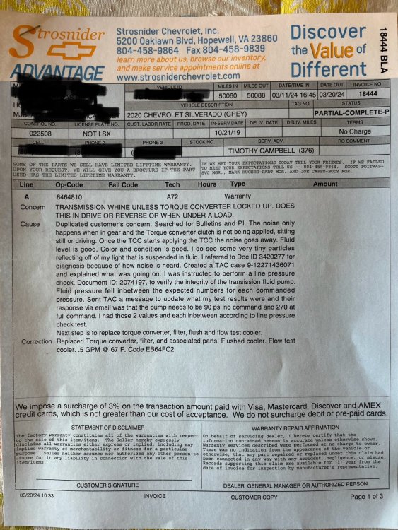

Hey guys, I know I’m late. I’m from the T1 forum. Just a heads up, my 2020 trail boss (4.3/6L80) has blown through two converters in 50,000 miles. First one went at 25,000. They never fixed the issues and the 4.3 converters are just as shabby as the V8 converters. My question is….could I put a 300 mm billet JMBX multi-plate from Circle D Specialties behind my 4.3? The truck is 5,019 pounds empty, and they recommended a 300mm. I think they all use the same flex plate.
They are not the same converter. Not even the same style. First 4.3 converter failure I've heard of. Phone Circle D on that one. I haven't a clue. :dunno:
Brian from Circle D recommended a 300mm JMBX.
Funny, I spoke too soon. Brian said my
converter is an oddball (258mm) and he said they didn’t offer one for me after corresponding that a 300mm looked nothing like mine. I’ve gone through 2 in 50,000 miles. It’s on number 3 as of today.
