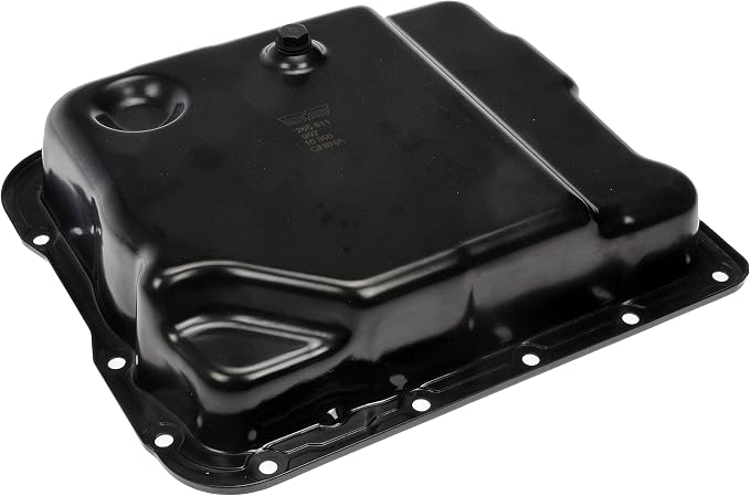

Does anyone know of a 4l60e pan with the drain plug in the middle or front?   Unfortunately the cross member is in the way on my 2WD '96 C1500.
as txab has shown you there are many aftermarket pans , i have been told the aluminum are better sealing and displace heat faster, amazon , summit racing ,  jegs , all have pans with drains , you have many choices, i also was told by transmission builders , get a deep pan
Edited by Brian Lindsey
Yeah, I've also found that the several of the more expensive pans, $150+ have drains in the center/front but I would definitely install my own plug before I paid that.  The dorman pan might work and I may give it a try even though I was trying to avoid a deeper pan.
Thanks!
The Dorman pictured above is the standard deep pan for the 4L60E. The 4L60E shows a shallow (flat pan) that fits it, but I never seen one on a truck. The Dorman matched my OE for depth, I snagged it years ago when Amazon had for like $10
I'm not 100% on this but my 2002 had a drain plug from the factory.  Couldn't you just get one from that year?
if you don't mind doing the work, you can get weld in bungs from motion raceworks or any other aftermarket parts distributor
I wasn't aware of that, that might be an option.
I think I'll add that one to my Amazon cart and wait for it to go on sale since I ended up reinstalling the stock pan for now.
