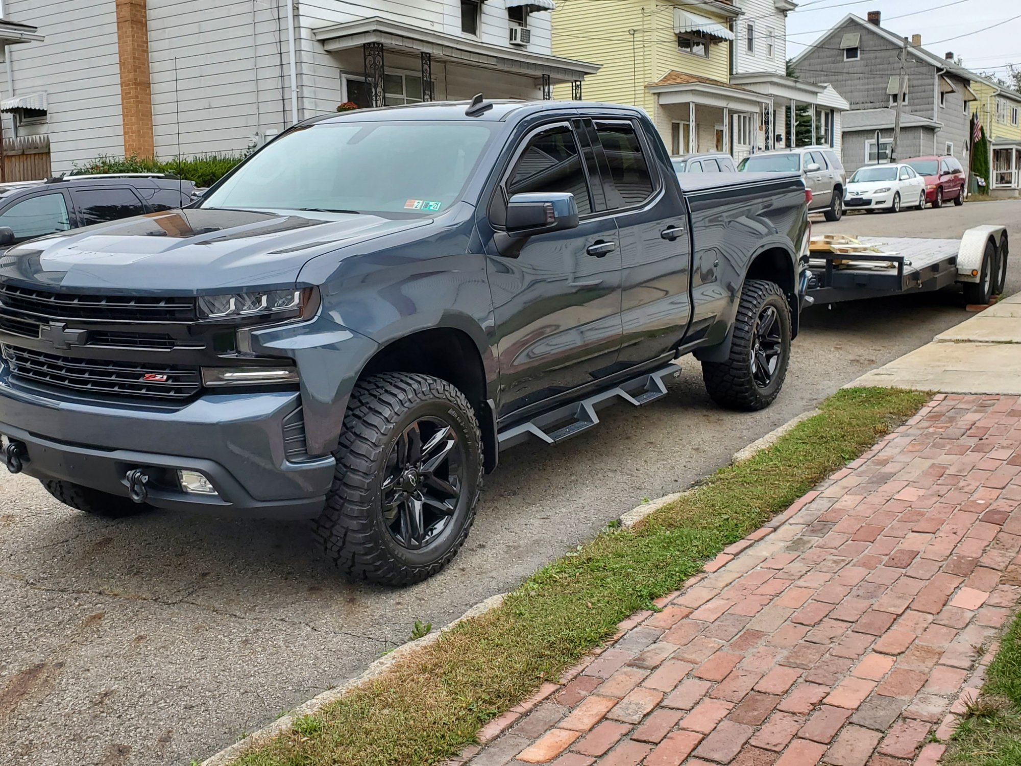

I had the stage one kit on my 19 last year , it drove decent but still too firm. I sent the coilovers back, they converted em to stage 4. That's long travel with the compression adjuster. Huge difference..!!  Now the stage 4 has tubular control arms and rear reservoir adjustable compression shocks. Here's 3.25 up front and 2 rear with 35s.
