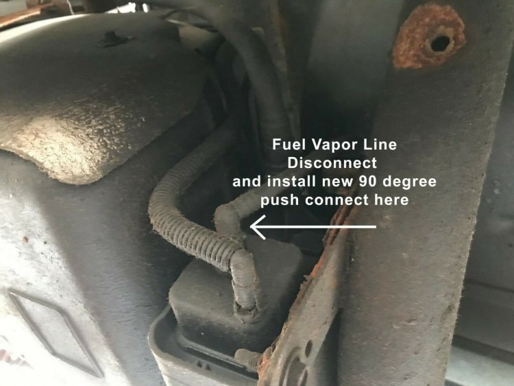

From what I have gathered from looking on the internet, my fuel vapor line is leaking fuel. It's leaking from a hole in the section between the fuel filter area and the engine, specifically the area where the three lines are held close together with those black plastic things. Kind of like right above the 4x4 driveshaft.
Anyway, is this line supposed to have a constant amount and alot of fuel in it? As soon as I turn the key far enough to activate the fuel pump it starts spraying fuel. It is a constant and steady spray of fuel coming out of it.

It is the evap line that has the fuel in it though. Unless the pictures I found digging around were labeled incorrectly. It's the line that goes into the side of this box (charcoal canister or something from the digging I've done). The pictures are not mine they're off Google images.
There should never be fuel in that line, if there is then you have a problem.
You will likely need to replace the charcoal canister now because it's full of fuel. Very possible that it's clogged and or the vent line is clogged or not flowing as good as it should. It could be creating a high pressure scenario in the fuel tank. Also make sure to not keep pumping gas after it clicks off, that can fill up the EVAP system if the tank it too full.
