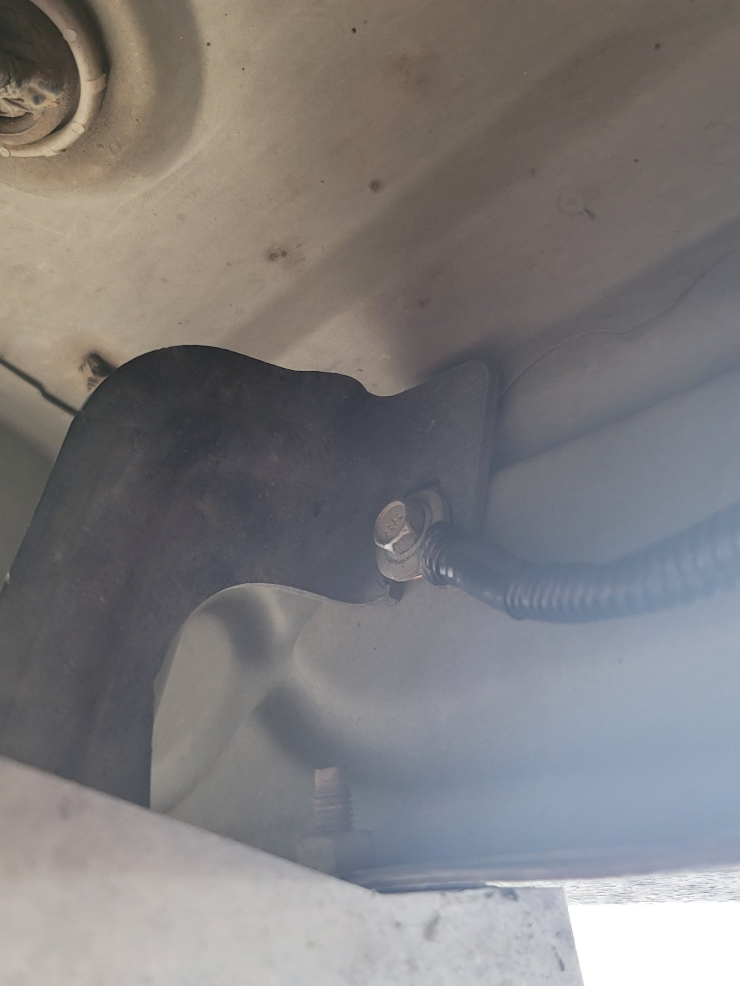

Passenger side; using existing bolt and nut.

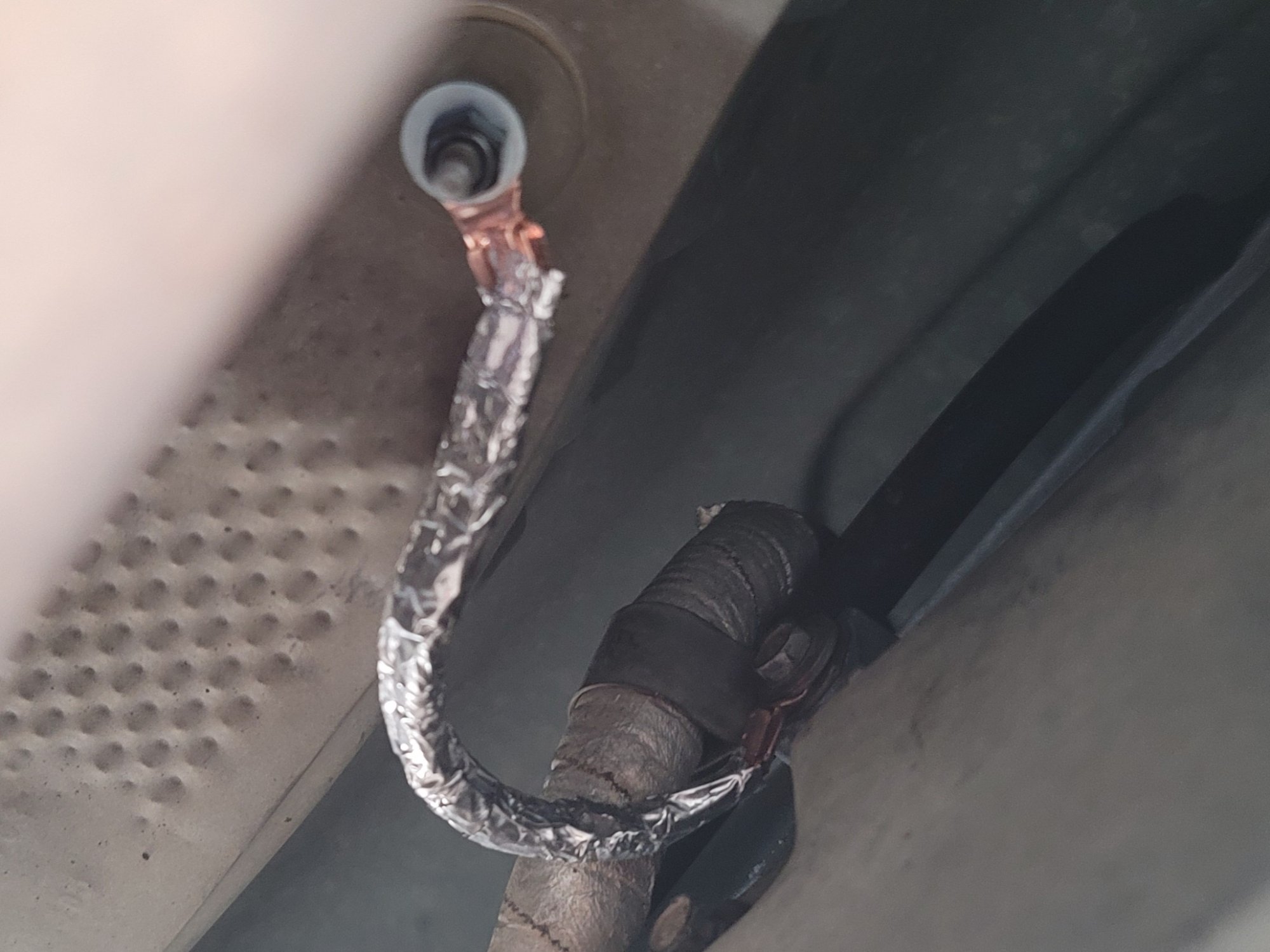

The wire is about 6 inches. It connects between the bolt that's holding transmission electrical wires to underbody heat shield. I added some heat resistant tape around the wire since it's so close to the exhaust.

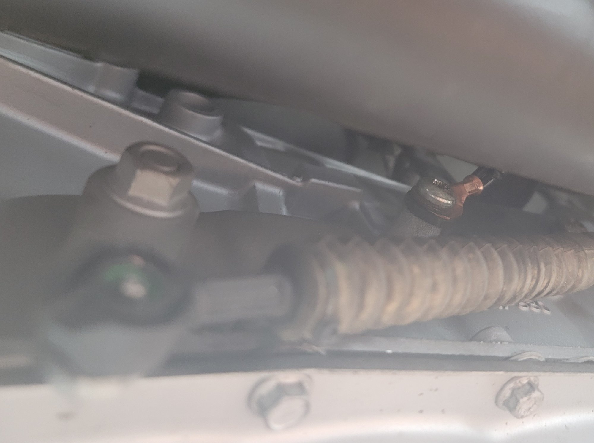

Driver side. I forgot to measure the length of the wire.
It connects between the shifting cable bracket to the bolt holding the side step.
