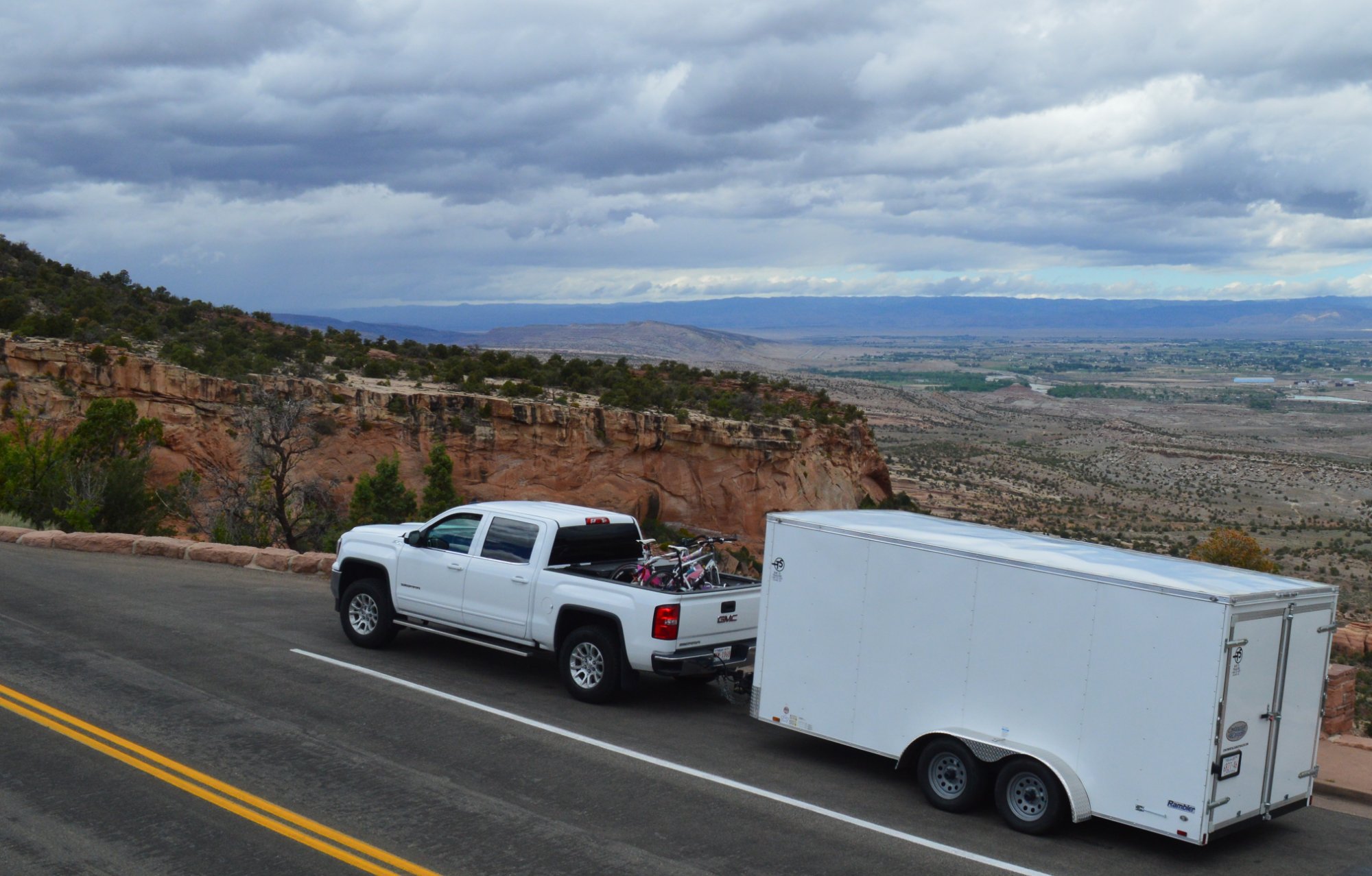

A few months ago, we moved from Calgary AB to Lincoln NE. We sold most of our bigger stuff, except for 1 bedroom set. I bought a 7x16 cargo trailer with a gross of 7000 lbs. My truck has the 5.3L V8 gas with 3.42 axle, so it's good to 9100 lbs towing. I took the trailer on a CAT Scale when fully loaded (it was FULL), it was around 6500 lbs.
We drove over a variety of terrain thru Alberta, Montana, Idaho, Utah, Colorado, Nebraska.
MPGs were between 8-11 most of the time, sometimes could get up to 13 on the flat sections with favorable conditions. But I wouldn't count on anything above 10 for the average.
Engine coolant and transmission temps were always good, even across Colorado on I-70, albeit she was a slow long pull up over Eisenhower Pass, i could not go above 50mph under full throttle.
Only upgrades were E rated tires, Timbren Bump Stops, and a 14000 lb Equalizer Hitch.
Moral of the story, we made it, the gas V8s do the job, but you'll REALLY wish you had a diesel for this kind of job. My truck is in storage at the moment, but when we get back from our year of travelling, I'm probably going to look at trading for a Duramax.
