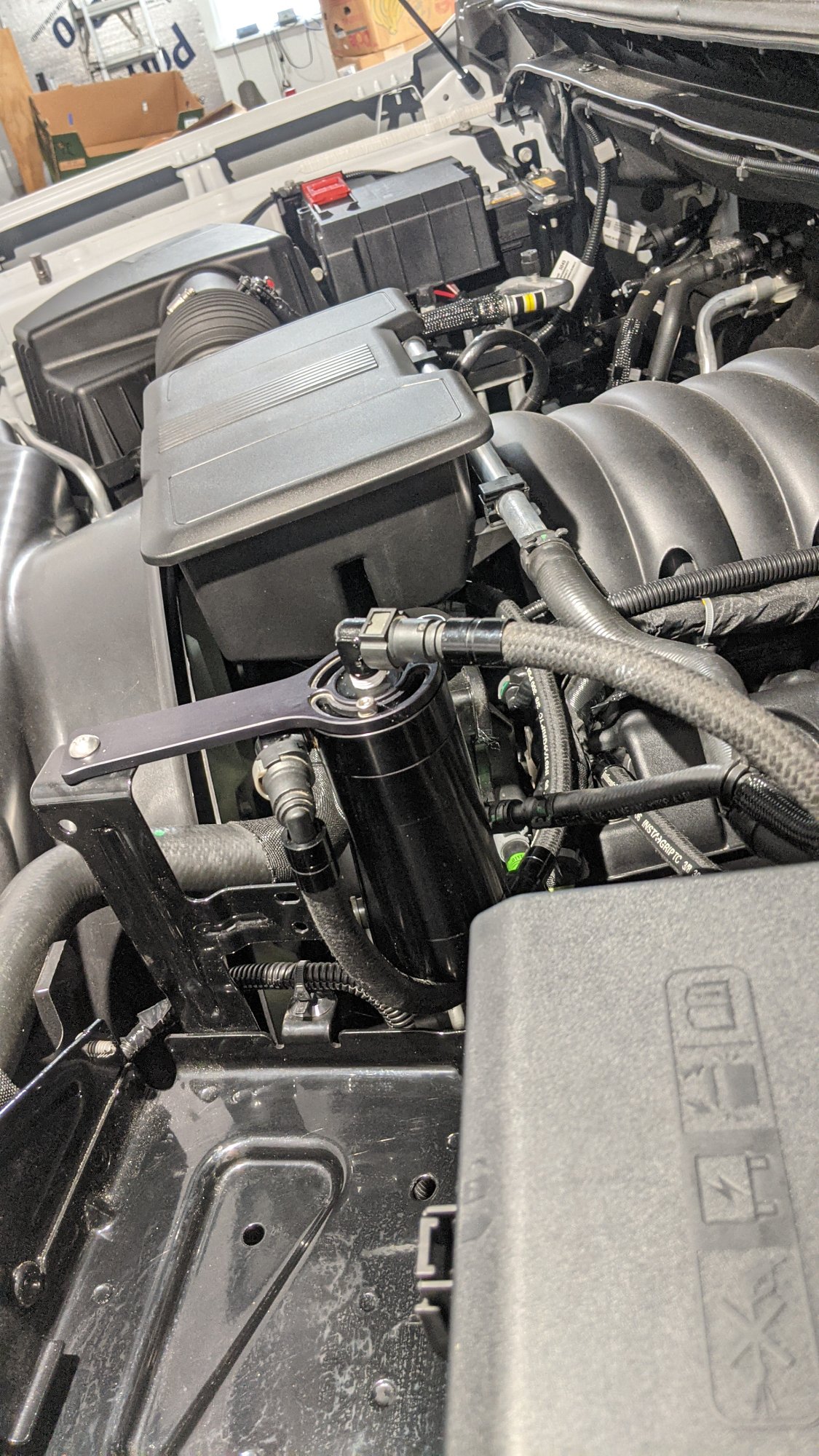

I repurposed the UPR catch can that I previously had on my 2018 GMC Sierra 1500.
The Kit UPR sells for the 6.6 liter gas has longer hoses and installs on the battery bracket. I found the bracket for the auxiliary battery tray work perfectly. My current hoses or a little longer than necessary but nothing too bad, overall easy to install and I'm happy with it.
what about the large hose on the passenger side valve cover going into the air box?
